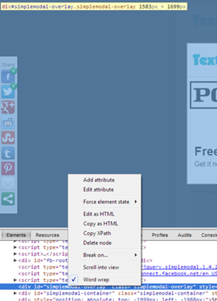

Not me because, well, I can read a DOM and I'm a developer by trade and Chrome has generously made sure I have access to a debugger that can modify in real-time just about any piece of a page.
That "delete node" option neatly eliminates the "social loginwall" with only minimal irritation on my part. Couple clicks and voila! I'm reading what you thought you were gating.
The lesson here is if your business model (and logic) require that a visitor be logged in to see certain content, you'd better make sure that it's enforced somewhere other than on the client.
C'mon. I've got marketing in my title for crying out loud. If I can circumvent your attempts to enforce application logic flows then, well, lots of other people can and honestly, there's probably a plug-in that will do it automatically for folks who aren't trained as developers.
