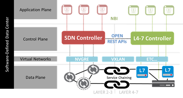

It is important - very important - to remember that SDN architectures, by design, only provide the visibility and control required to implement security at the lower order layers of the network stack. Specifically, layers 2-4. That's data link, IP, and TCP (and sometimes UDP) for the uninitiated.
Note that nowhere in that list is "application" mentioned. The application layer is way up at the top - at layer 7 - and in 64% of applications4 that means HTTP.
Interestingly, there's nothing stopping an SDN "application" from inserting itself into the SDN controller (via the northbound API) and providing application layer security by acting as a full proxy and inspecting every single packet. Well, nothing except for scalability and performance of the SDN controller, which was not designed to be a part of the active data path. The architecture was designed to focus on the network, on forwarding packets and managing flows, not inspecting application layer transport protocols and the data it carries. But that's exactly what's necessary to provide the kind of application layer defenses required in this brave, new application attack-based environment. Inspection of payloads, not packets. Evaluation of clients, not connections.
This is not to say that an overarching SDN architecture can't provide for both network and application layer security.  An integrated solution comprising both network and application-layer elements will ultimately provide the comprehensive top-to-bottom (of the stack) security desperately needed to defend against attackers. What you won't see are SDN applications that provide true application-layer security. For that, you'll need focused data path elements and, most likely, an application service management and orchestration component to control those elements. The application service management  and orchestration component then integrates with the SDN controller (control plane) and executes via service chaining (data plane) to enable defense of the entire network - and applications.
