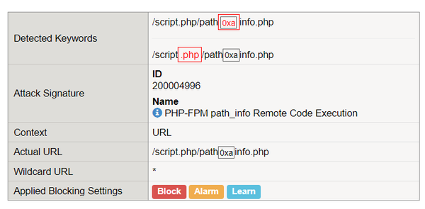

A new attack signature was released to provide a more accurate detection and mitigation of the vulnerability: "PHP-FPM path_info Remote Code Execution" (ID 200004996) in the "Server Side Code Injection" signature set.

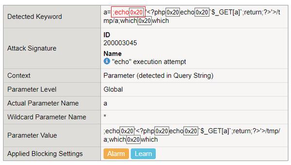

ASM customers under any supported BIG-IP version are already protected against this vulnerability. While exploiting this vulnerability attacker will try to send specially crafted HTTP GET requests containing multiple command and PHP injections.
Figure 1: Request example containing the exploitation attempt

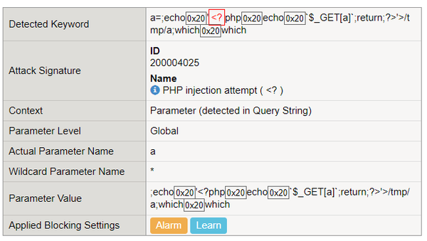

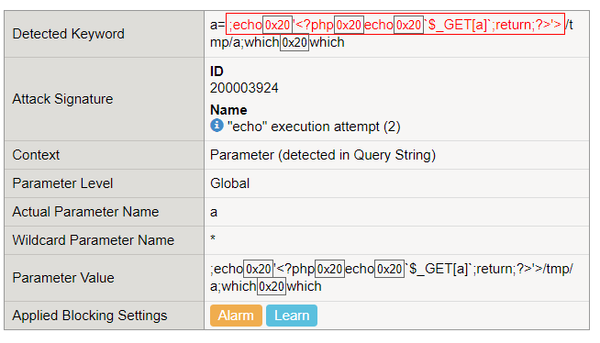

The exploitation attempt will be detected by many existing attack signatures. Signatures which can be found in signature sets that include "Command Execution" and "Server Side Code Injection" attack types or "PHP" system.
Figure 2: Exploit blocked with Attack Signature (200003045)
Figure 3: Exploit blocked with Attack Signature (200003924)
Figure 4: Exploit blocked with Attack Signature (200004025)
