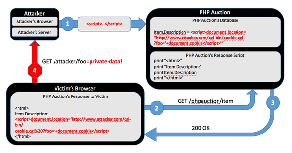

Here’s how the attack flow works (image recreated for this specific example from an image at excess-xss.com):

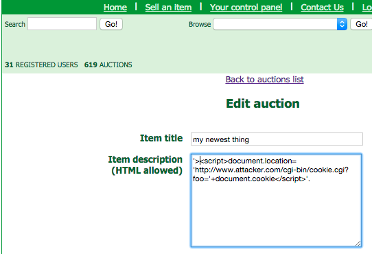

In the phpauction site, I add a new item to sell, but instead of putting in an actual description, I inject the script:

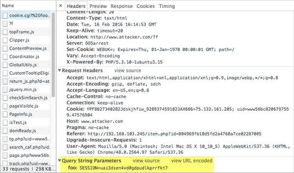

After saving the item, I visit it. Here’s the screen shot confirming that, after connecting to that auction item, my session data was transmitted in the foo query parameter to the attacker site (in yellow at the bottom of the image!)

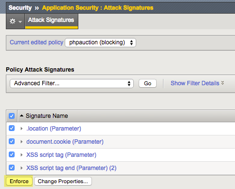

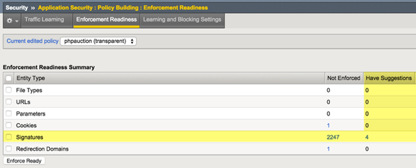

So how do we stop this nefarious behavior? Well that’s where ASM really shines. John covered how to build a policy in part 2 of his ASM series, which I followed for this example. Once I got the policy built and attached to the virtual server, I ran some test traffic to the auction site and attempted another xss injection, which was successful as the policy was in transparent mode. It did however publish some recommendations it learned from my injection attack, which I accepted and then applied the policy. Clicking the have suggestions column on the signatures row took me to the injections I applied:
Which takes me to this screen showing me the matching signatures:

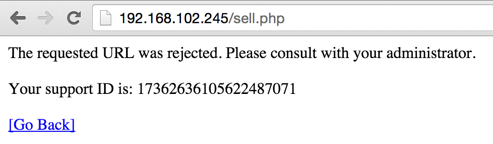

Once those were accepted and the policy applied (and moved from transparent->blocking!) I then tried to attack again by inserting the same script into the description field of a new item.
Good news! And here’s the report from ASM:
Walking through the report step by step:
  • In yellow, this is the log entry that matches my attack attempt
  • The green shows me that it was blocked due to matched attack signatures
  • Blue shows me the matching support id and the policy it applied to
  • Purple is the list of matching attack signatures
  • Light orange shows the actual payload that matched and the particular signature highlighted in red.

  • Hi, I am a bit confused - either I am not getting it right or there are some errors in the article: a) Script shown in description field is different than scripts displayed in both the flowchart and then on Request detail page of ASM b) Values in request cookie are not the same as value highlighted as query parameter Am I right that it's an error or I am missing something? Piotr
  • you are correct, I put the wrong image in there. I had a second attack I ended up not using and got the images confused. I'll get this fixed when I get back in the office tomorrow.
