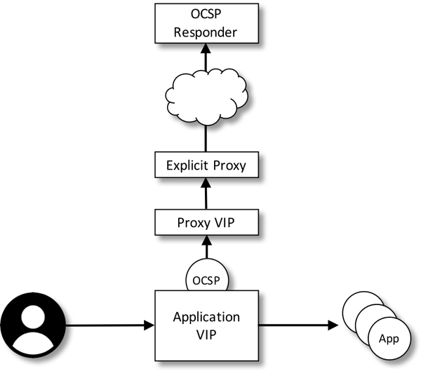

Hey DC community, Kevin Stewart here with a fun little project I'd like to share.
There have been countless questions about this over the years: how to pass LTM or APM OCSP requests through an outbound explicit proxy. We've already established that you can create a simple VIP and iRule that "proxifies" an outbound OCSP HTTP request, and that you can point the OCSP responder configuration URL directly at this layered VIP.
But what if client certificates need to be validated against different OCSP responders, based on the X509 AIA extension? AIA, or "Authority Information Access" is an X509 certificate extension that identifies, among other things, the OCSP responder URL that a given client certificate should be validated against. The LTM and APM OCSP clients (as of 13.1) don't pass an HTTP Host header, and don't allow you to inject any "signaling" information into the outbound OCSP request. That means there's no easy way to get the client's real certificate AIA value over to the proxy VIP, plus you need the OCSP responder to point to the proxy VIP anyway.
The answer is to signal "out-of-band" - at the application VIP, catch the certificate issuer, serial and AIA values into a table,
issuer_hash:serial = AIA
and at the proxy VIP, catch the issuer and serial in the OCSP request and look up the AIA URL from the table. The issuer value in the OCSP request is a SHA-encoding of the issuer value from the DER-formatted certificate. You can't just SHA hash the X509::issuer value. That'd be too easy. It's necessary then to binary parse the issuer directly from the binary certificate blob. The OCSP request is already binary, so you have to binary parse this data anyway.
Before I get into the details, I should warn you that there's a lot of binary processing TCL code in these iRules, which a) isn't for the faint of heart, b) isn't great for performance, and c) isn't going to correct for every type of certificate. I did test this with sha1WithRSAEncryption and sha256WithRSAEncryption certificate signature algorithms, across both RSA and EC certs, and these all worked. It's also worth noting that the performance loss may be neglible given that OCSP itself will be the bigger hit. However, things like TLS session resumption should keep full handshakes and OCSP validation from happening as much over a set of active user sessions.
The configuration looks basically like this:
  • Create your application VIP, pool, and client SSL profile as required. Test without client cert auth first to makes sure basic flow and functionality works as expected.
  • Create an internal "proxy" VIP and pool that points directly at the outbound explicit proxy (ex. 192.168.2.1:3128), and attach the proxy iRule. You can also create an empty VLAN (no interfaces), attach a unique self-IP to that VLAN (ex. 11.11.11.1), and assign an IP from that subnet to the proxy VIP (ex. 11.11.11.2:80) to keep all OCSP proxy traffic internal. Also make sure the proxy VIP is listening on the correct VLAN, enables address and port translation, and SNAT as required.
  • If using LTM OCSP, create the OCSP responder, configuration and profile.
  • If using APM OCSP, create the OCSP responder AAA and an access policy VPE that starts with the OCSP authentication agent - the included iRules parse the certificate issuer, serial and AIA from CLIENTSSL_CLIENTCERT, so the client SSL profile needs to request the client certificate (versus the APM On-Demand Cert Auth agent). This could also be done completely within the Access context, but I'm not adding that code right now (maybe later).
  • Point the OCSP responder URL at the HTTP proxy VIP URL (ex. http://11.11.11.2) and check "ignore AIA". If APM OCSP, set CertID Digest to SHA-1. LTM OCSP automatically uses SHA-1.
  • Attach the application iRule to the application VIP, and attach either the LTM OCSP authentication profile or APM access policy to the application VIP.

To recap, an OCSP responder configuration (LTM or APM) points to a local "proxy" VIP (and ignores AIA). The application VIP iRule first grabs the client certificate AIA URL, serial number, and issuer hash, and throws those values into a table. Upon client certificate authentication, the OCSP responder client issues an OCSP request that flows to the proxy VIP. The proxy VIP grabs the issuer hash and serial number from the OCSP request, looks up the AIA URL in the table, and dynamically changes the HTTP URI value in the outbound request to the explicit proxy, to effectively proxify the OCSP request.
As stated, this should work with sha1WithRSAEncryption and sha256WithRSAEncryption certificates. If you come across a certificate that uses something else, please let me know.

                set AIA [findstr [X509::extensions [SSL::cert 0]] "OCSP - URI:" 11 "\n"]
                #remove : from serial
                set serial [string map { ":" "" } [X509::serial_number [SSL::cert 0]]]
                table set -subtable OCSP_AIA "${issuer_hash}:${serial}" "${AIA}" 300 300
