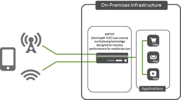

TCP is built on the notion of a single connection between 2 hosts. MPTCP discards that notion and enables a device to seamlessly switch between and/or simultaneously send a TCP connection over multiple interfaces.
Basically, MPTCP splits up a TCP connection into subflows, and is able to (based on the device) dynamically route messages across either of those subflows. This is, you're thinking, perfect for HTTP exchanges which often require a significant number of "sub-requests" for a client to retrieve all the objects required for an given web page/application.
Exactly. You're sending (and one hopes receiving) data twice as fast. Which on a mobile device is likely to be very noticeable.
