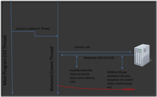

Diagram of relevant program flow
The above diagram is simply for reference. Some people understand easier with a diagram, so I built you one with just the parts we’re going to care about in it.
