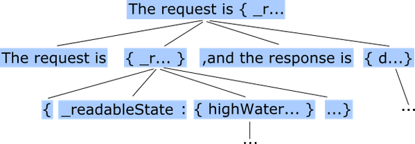

2. Defer string concatenation
What's the difference between this call
log.debug('The request is ' + util.inspect(servReq) +
          ', and the response is ' + util.inspect(servRes));
and this one?
log.debug('The request is ', servReq,
          ', and the response is ', servRes);
These statements both produce the same output. Let's consider what happens if you're not running at the debug log level. Suppose we're running at logLevel INFO (the default in my simpleLog library).
Let's see what happens in the first call. Our code says to call log.debug() with one argument. The argument is a long string formed by concatenating 4 smaller strings:
  • 'The request is'
  • util.inspect(servReq)
  • ', and the response is '
  • util.inspect(servRes)
You can check out the implementation of util.inspect() and probably notice that there's a lot of things going on, including recursive calls. This is all building up lots of little strings, which are concatenated into bigger strings and finally returned from util.inspect(). The javascript language is left-associative for string concatenation, but different engines may optimize as long as there aren't observable side effects; conceptually you can think about the costs by thinking about the tree of strings that the engine is building:
The 2 hard-coded strings and the 2 strings returned from util.inspect() are concatenated one last time into the argument to log.debug(). Then we call log.debug(). If you're using my simpleLog, you can see that the first thing it does is bail out without doing anything:
if (!levels[level] || levels[level] > levels[currentLevel]) { return; }
So we went through all the effort of building up a big string detailing all the aspects of the server request and server response, just to unceremoniously discard it. What about the other style of call (spoiler alert: it's better :-)?
Remember the second form passed four arguments; 2 arguments are just plain strings, and the other 2 are objects that we want to dump:
This style is taking advantage of a console.log() behavior: "If formatting elements are not found in the first string, then util.inspect is used on each argument." I'm breaking up the arguments and asking console.log() to call util.inspect() on my behalf. Why? What's the advantage here?
This structure avoids calling util.inspect() until it is needed. In this case, if we're at loglevel INFO, it's not called at all. All those recursive calls and concatenating tiny strings into bigger and bigger ones? Skipped entirely. Here's what happens:
