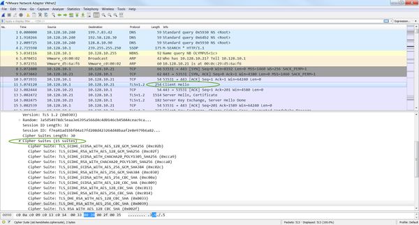

Last, the naming convention for the cipher suites is best tracked by using the hexadecimal value associated with each suite. I captured a Client Hello and Server Hello for a test web application I have. I'm using BIG-IP v12.0 for this, and I have the DEFAULT cipher suite enabled for my client SSL profile. Here's the Wireshark capture for the Client Hello:
Notice that the browser sends 15 different cipher suites to the server for consideration. Each cipher suite has a hexadecimal value listed to the right of the cipher suite. Keep an eye on cipher suite hex value 0x0039. This will be the one that is ultimately selected by the BIG-IP for this session. Here's the Server Hello Wireshark capture that happened right after the Client Hello:

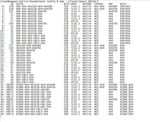

Notice that the BIG-IP (Server) chose the cipher suite with hexadecimal value 0x0039. The Wireshark capture does a good job of letting you know what's in the cipher suite (TLS_DHE_RSA_WITH_AES_256_CBC_SHA (0x0039)), but that doesn't always correspond exactly to the naming convention of the BIG-IP list of cipher suites. Here's a list of the DEFAULT cipher suites on my BIG-IP:

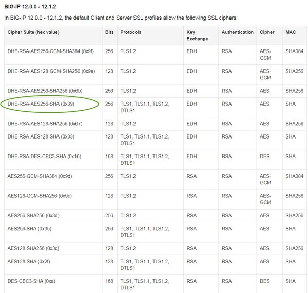

Notice that the naming convention is a little different here. So, in order to correspond the Wireshark list of cipher suites to the BIG-IP list, you should use the hexadecimal value. Unfortunately, the BIG-IP doesn't list the hexadecimal value of the cipher suites by default, but you can cross-reference them using this link: https://support.f5.com/csp/article/K13156. Here's a screenshot of the BIG-IP version 12 cipher suites (notice that the hexadecimal values are listed for each one). And, I circled the 0x0039 so you could track the same cipher suite that was used throughout this session.

Last one is about what is the easiest way to match naming convention used by BIG-IP (tmm --clientciphers DEFAULT) to one used by Wireshark.
Let's say in Wireshark I can see TLS_RSA_WITH_AES_256_CBC_SHA (0x0035), on BIG-IP I have a list of ciphers. My guess is that matching entry is:
35: 49172 ECDHE-RSA-AES256-CBC-SHA 256 TLS1 Native AES SHA ECDHE_RSA
but Am I right?
Convention looks a bit different so hat would be a way to be sure that one matches other?
