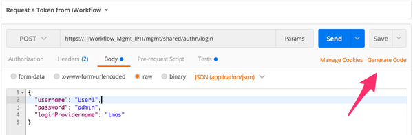

Step 1 - With the desired transaction open, click “Generate Code”.

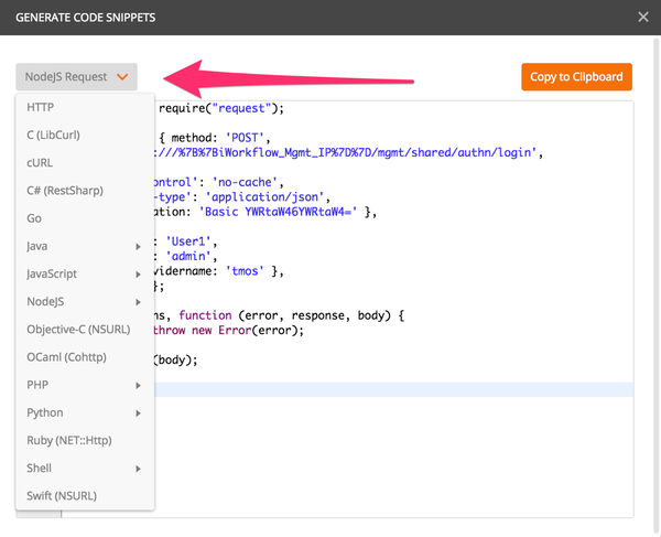

Step 2 - In the window that appears, select the desired language from which you require to execute the REST transaction.
Step 3 - Copy that data and start scripting! Or hand it to someone in your organization who’s looking to self-serve their L4 - L7 service templates via REST.
