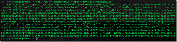

For these examples we’ll be using cURL, so let’s take a look at what that looks like. The first thing you’ll want to do, most likely, is get a listing of some different commands you can run. Of course, as I’ve said many times now iControl REST follows the tmsh structure, so if you’re familiar with that it will be nothing new. The rest of the setup, however, may be interesting. First we’ll use cURL to send a basic command to the BIG-IP asking it for a list of management resources. For this we use the –s (silent) and –k (insecure) cURL flags to strip out all status/usage info and allow for insecure SSL negotiation. We’ll also use –u to supply a username:password combo. This will get us into the test device and allow us to get an actual response. The constructed command looks like this (Keep in mind the output will vary per device based on version, configuration, etc.):
curl –sk –u admin:admin https://dev.rest.box/mgmt/tm/

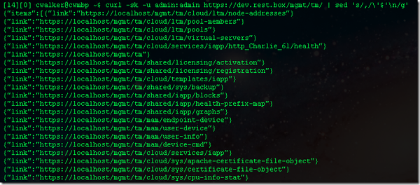

That isn’t hugely useful to a human, however, since it’s not overly readable. Given the formatting, however, it is pretty simple to break at each comma and insert a newline. We can do that easily from the command line to make this much more human readable. Here’s the appropriate sed string appended to the original command from above. Note that this is a bit different given that I’m running on a Mac, so I tweaked the regex replace a bit to suit my needs, though it should function fine on either Linux or OSX.
curl -sk -u admin:admin https://dev.rest.box/mgmt/tm/ | sed 's/,/\'$'\n/g'

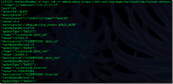

What you’re seeing here is a list of available resources that you can query via iControl REST. Each of these is a part of the underlying tmsh system. This list goes on and on, the above is just a truncated snippet. If you’re looking for specific commands, check out the tmsh documentation and have at it. From this point it’s trivial to start sending commands that might get you useful information back from your device. Whatever you can think of you can send, for the most part. How about something handy like listing all virtual servers on your device and their associated info? Be warned that the below command will likely get you a huge amount of output on a device with a decent config. To list all virtuals you would do something like:
curl -sk -u admin:admin https://dev.rest.box/mgmt/tm/cloud/ltm/virtual-servers | sed 's/,/\'$'\n/g'
Again, this goes on and on, the above is just a snippet. Seriously, Note the familiar JSON formatting here. You have an item, identified by the address, and a list of name value pairs of info related to that item, including sub lists where necessary. This should look familiar to anyone that’s dealt in this kind of structure before. It is this simple, easy to parse formatting that is part of what makes iControl REST as widely applicable and easy to pick up or integrate as it is.
