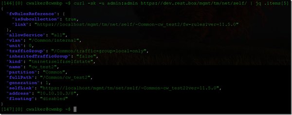

First let’s take a look at the object we want to remove:
As before, you can see the object output. Listing things like this is always a good idea, especially when doing things manually like we’re doing here for testing, to be sure we have the object we actually want before nuking anything. This is, in fact, the item bound for the bit bucket in our case, so let’s make with the destruction.
