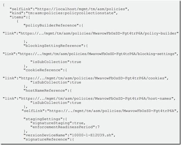

Once you have a list of the resources, as above, you can dig a bit deeper to get the details of a given resource pass another GET to one of the specific resource URLs, which will expand upon what is available. This looks like:
GET https://192.168.25.42/mgmt/tm/asm/policies
… and again, this carries on depending on the running config.
As you can see, at least the listing of objects and items is very much the same as what you’re used to in the rest of ASM. Next time we’ll dig in a bit more to creating and modifying objects which will look a little bit different.
