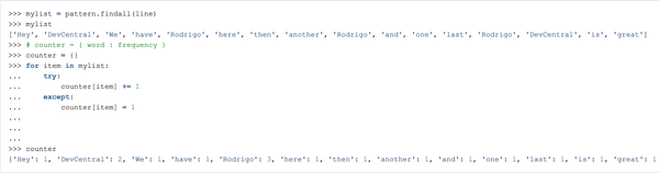

Creating a counter for words/numbers
We can create a dictionary to keep track of number of words:
But why reinvent the wheel, right?
We can use collections.Counter instead:
Now that we have broken down the words into a list using Regex and added each word and corresponding counter to a dictionary, we're ready for the final solution.

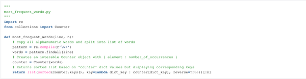

And this is our code in one line:
Putting it all together
This is how our pythonic code could look like:
And here's the final output:
