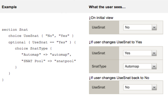

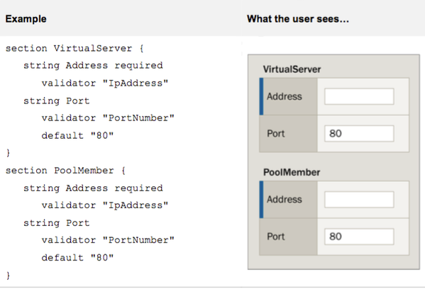

Make sure to use the layout elements to your advantage. Use the section element to group like features/functionality in your iApp.
Hide stuff that isn't required for particular deployments by using the optional element. This makes readability much better

Use validators for input fields where they are supported. These are some common validators:
  • Number:  Any integer
  • NonNegativeNumber: Any integer >= 0
  • IpAddress:  * for all addresses, or an IPv4 or IPv6 address
  • PortNumber: * for all ports, or an integer value between 0 and 65535 inclusive
  • FQDN: RFC 1034 compliant domain name
  • IpOrFQDN: IPv4, IPv6, or an RFC 1034 complaint domain name. * not allowed

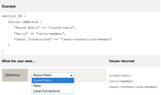

Also very helpful: you can display user-friendly wording while setting a different value that is passed on to the implementation. This is nice for things like the load balancing method, where least-connections-member isn’t awesome to look at, but is the required text string for the tmsh::pool create/modify command.

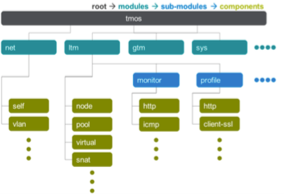

The implementation section is pretty much a tmsh script, without the required skeleton. the hierarchy of tmsh, for those not well versed, looks like this:
The general syntax of tmsh commands is:
tmsh <command> <module> [<submodule>] <component> <parameters>
