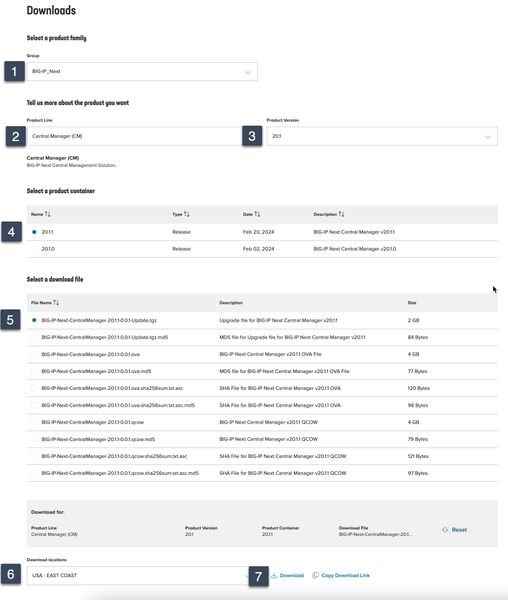

The first step in the upgrade process is to download the BIG-IP Next Central Manager upgrade package.

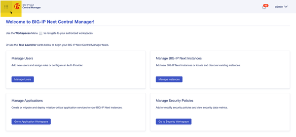

After you have the upgraded package, login to your Central Manager. Click in the upper left on the tic-tac-toe board.

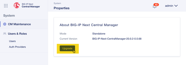

Then in the dropdown menu that appears, select the System option.
There's only one option here currently, and that's the upgrade button. Go ahead and click it.

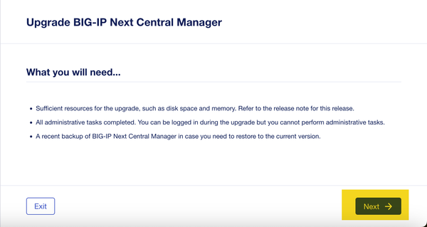

There will be a couple notes on the new window about resources and information on the unavailability to perform tasks during the upgrade. Go ahead and click next.

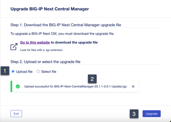

If you didn't grab the package yet, the link to do so is included on this menu page. I selected the upload file option, selected the package from my downloads, and uploaded the file. You'll get the "green means go" checkbox when it's ready, at which point you can click the upgrade button.
On the "Are you sure?" alert dialog, go ahead and click yes, upgrade.

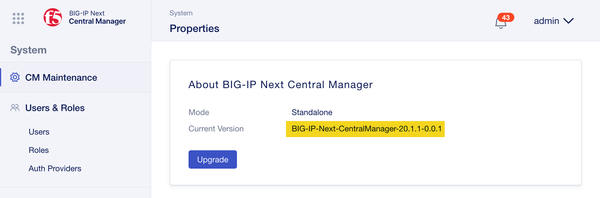

And with that, you can see the new version of code. Congratulations on your first upgrade of Central Manager.
