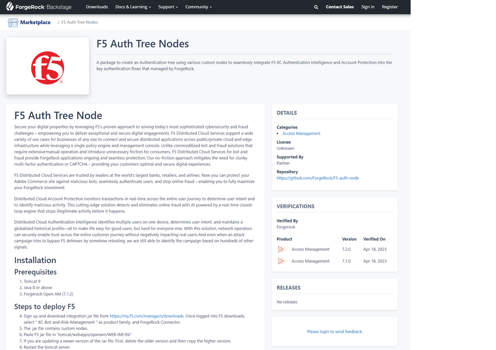

Step 1: Create the F5 .jar file
The first step will be to visit the ForgeRock backstage and type in "F5".  Next choose, "F5 Auth Tree Nodes" which will land at this page
  Figure 1:  F5 Auth Tree Node backstage landing page
Following the steps above will create the specific F5 XC nodes which are required for building the tree.

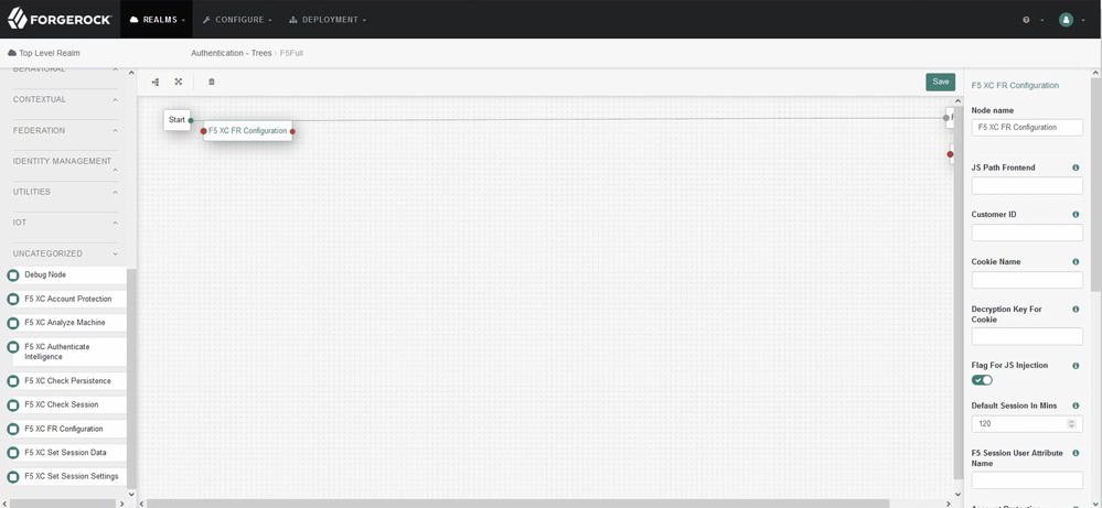

Figure 2: Creation of new tree

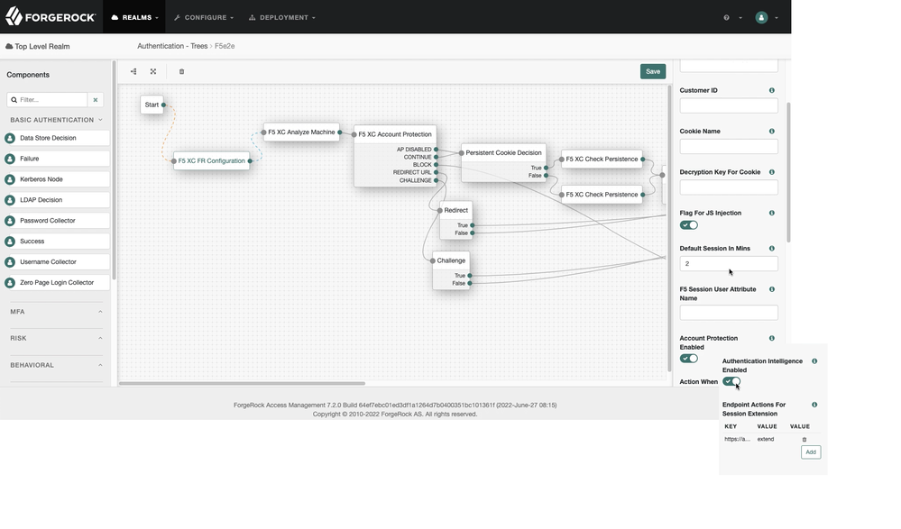

The most important node is the "F5 XC FR Configuration" node which houses the service specific information as well as the defined attributes for Account Protection and Authentication Intelligence.
Figure 3: F5 XC FR Configuration node
Please note that Authentication Intelligence endpoint configurations are the same as Account Protection endpoint configurations.

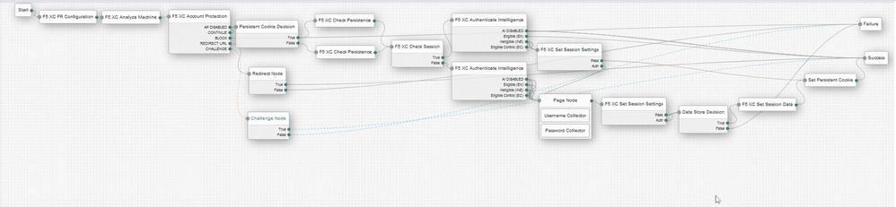

The completed tree will look like this
Figure 4: Completed Authentication tree
This integration is based upon encrypted cookies which are used to send the fraud recommendations from F5 XC. The cookie is collected from the website by the "F5 XC Analyze" node and then is decrypted by the "F5 XC Account Protection" node. For the protected endpoints, the "FR" value is read and then an action is then taken based upon the customers configurations as defined in the "F5 XC FR Configuration" node.

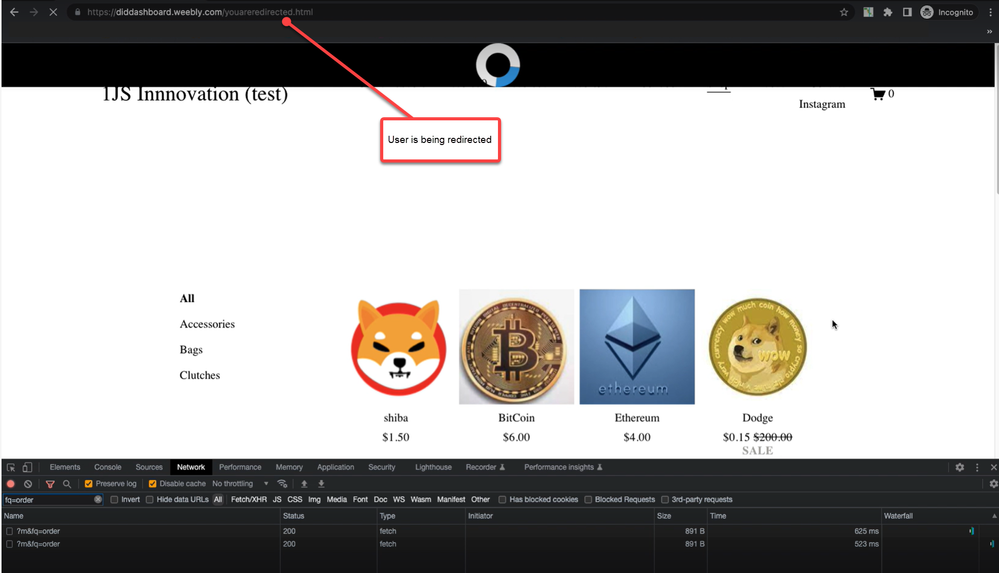

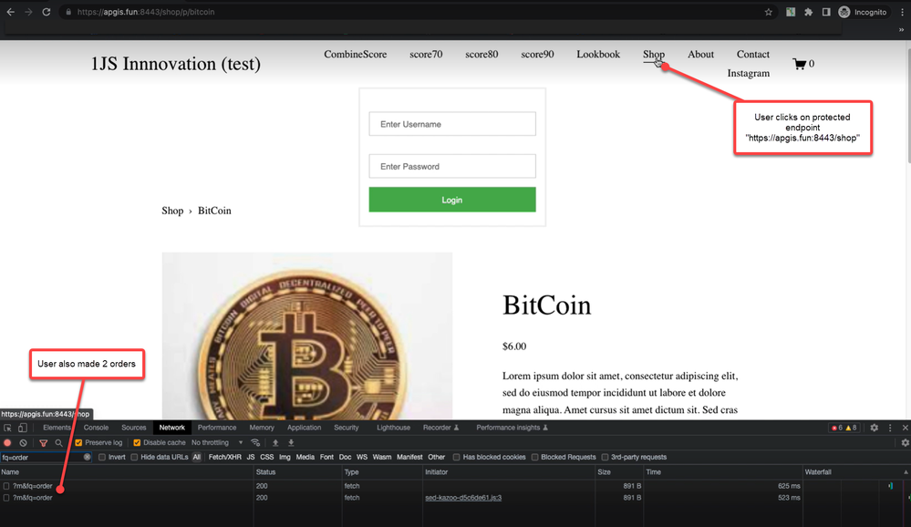

In this example, to demonstrate the power of Account Protection, let's say a merchant is protecting his "Shop" endpoint. A user visits the website and makes more than 2 orders and then visits the protected "Shop" endpoint. Based upon the collected telemetry the recommendation comes back as fraud. The previously defined action in the ForgeRock tree is to redirect the user.
Figure 5: User triggering redirection action

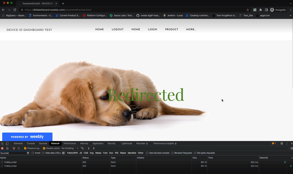

Next we can see the webpage begins to take the action of redirect as per the pre-configured action based upon the fraud recommendation.
Figure 6: Endpoint beginning the redirection
And then the actual website used for redirection.
Figure 7: Successful redirection of the user

Starting off in the ForgeRock Access Manager, we see the flag for JS injection is ON, the default session is set for 2 minutes, Authentication Intelligence is Enabled, and the action for the "https://apgis.fun:8443/index1" endpoint is extend.

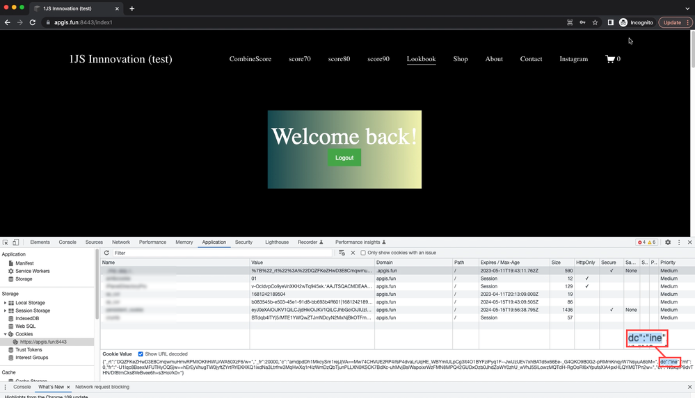

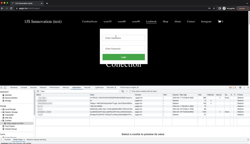

After the "e1" user logs into the endpoint, despite it having an action of extend, the recommendation for that user is ineligible as seen below. This means that the user is ineligible for a session extension, so the session will be the default of 2 minutes.
 Figure 9: Ineligible user for session extension

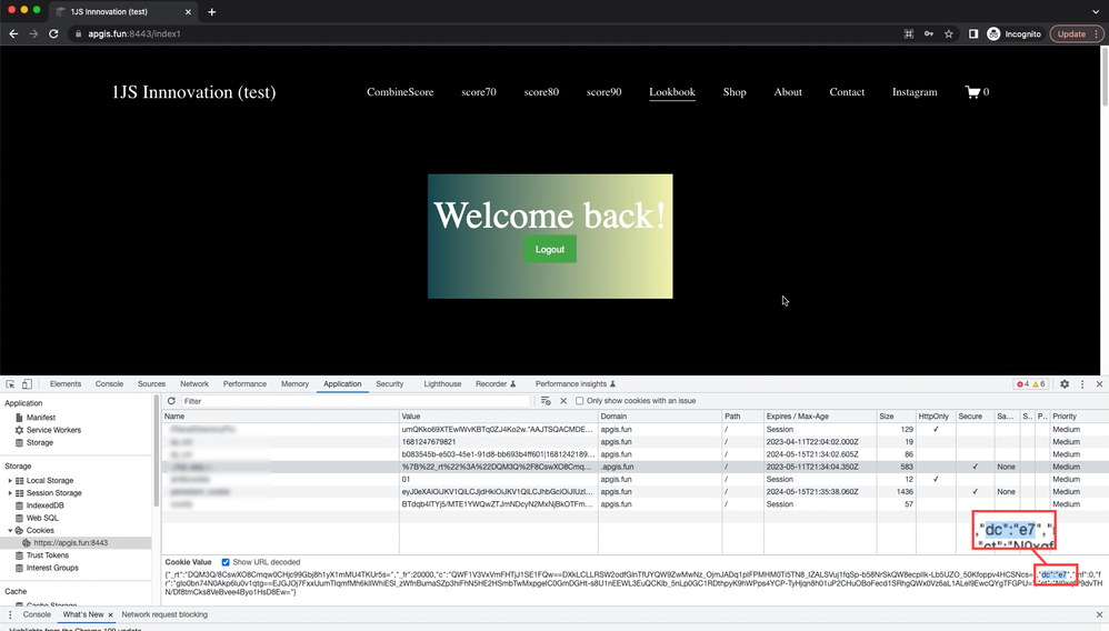

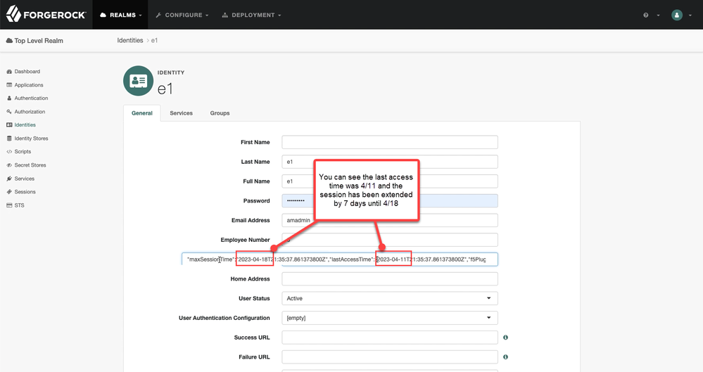

Now let's say that the recommendation comes back as eligible for a session extension of 7 days.
Figure 11: User eligible for 7 day session extension
 This can be verified under the Identities menu in the ForgeRock Access Manager.
Figure 12: Access was extended to 7 days
Please note that "dc" value in the content of the cookie is being shown in plain text for illustrative purposes, in a production environment, the "dc" value is stored inside encrypted content.
