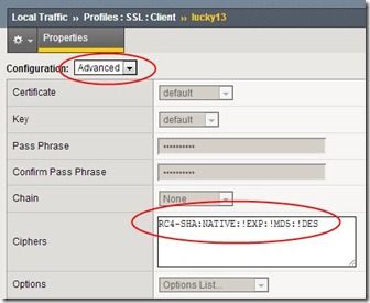

      Recommendation:
      For any virtual server that is not hardware-accelerated (or if you are unsure), consider switching your TLS ciphers to prefer RC4.
      There are probably better cipher strings out there, but I tested this one on Chrome and IE and it looks to give the right result.
      RC4-SHA:NATIVE:!EXP:!DES:!MD5
      MD5 has nothing to do with this, but it is force of habit for me to exclude it.
