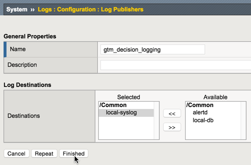

Log Publisher
The first object is the log publisher. For as much detail as flows in the decision logging, I’d highly recommend using an HSL profile to log to a remote server, but for the purposes of testing I used the local syslog.
This can also be done with tmsh.

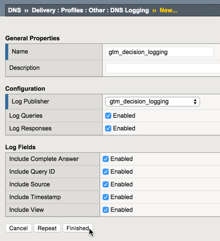

DNS Logging Profile
Next, create a DNS logging profile, make sure to select the Log Publisher you created in the previous step. For testing purpose I enabled the log responses and query ID as well, but those are disabled by default.
This also can be created in tmsh.

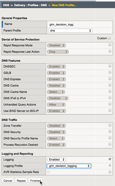

Custom DNS Profile
Now create a custom DNS profile. The only custom properties necessary are at the bottom of the profile where you enable logging and select the logging profile.
This can also be configured in tmsh.

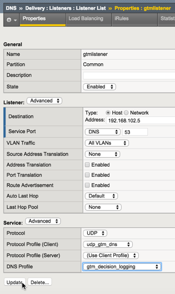

Apply the DNS Profile
Now that all the objects are created, you can reference the DNS profile in the listener.
in tmsh, you can modify the listener by adding the profile or if one already exists, replacing it.
modify gtm listener gtmlistener profiles replace-all-with { udp_gtm_dns gtm_decision_logging }
