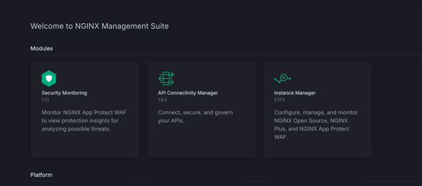

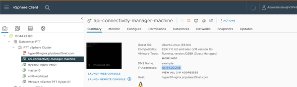

Once the terraform build is complete, I will see the NGINX Instance Manager VM running in the vSphere console.
I can open a new tab in my browser and enter the IP address to connect and login with admin/$TF_VAR_admin_password creds.
