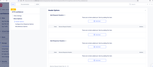

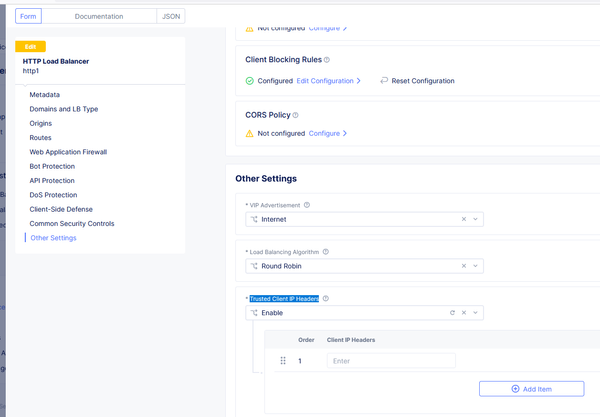

Under the HTTP load balancer under "Other Options" under "More Options" the "Header Options" can be found.
Then the the predefined variables can be used for this job like in the example below the $[client_address] is used.

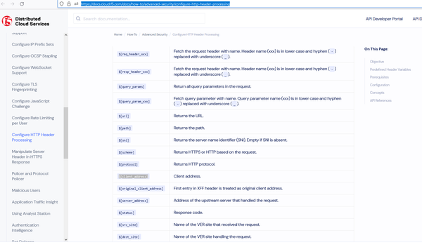

A list of the predefined variables for F5 XC:
https://docs.cloud.f5.com/docs/how-to/advanced-security/configure-http-header-processing

2. Matching of the real client ip HTTP headers

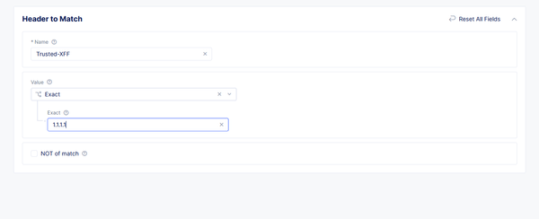

You can also match a XFF header if it is inserted by a proxy device before the F5 XC nodes for security bypass/blocking or for logging in the F5 XC.

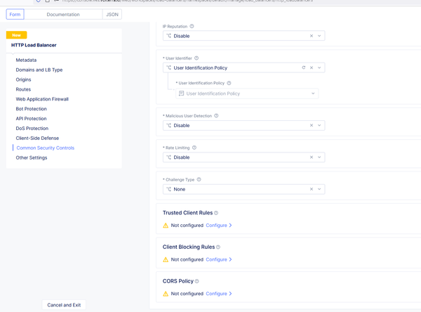

For User logging from the XFF Under "Common Security Controls" create a "User Identification Policy". You can also match a regex that matches the ip address and this is in case there are multiple IP addresses in the XFF header as there could have been many Proxy devices in the data path and we want see if just one is present.
For Security bypass or blocking based based on XFF Under "Common Security Controls" create a "Trusted Client Rules" or "Client Blocking Rules". Also if you have "User Identification Policy" then you can just use the "User Identifier" but it can't use regex in this case.

To match a regex value in the header that is just a single IP address, even when the header has many ip addresses, use the regex (1\.1\.1\.1) as an example to mach address 1.1.1.1.

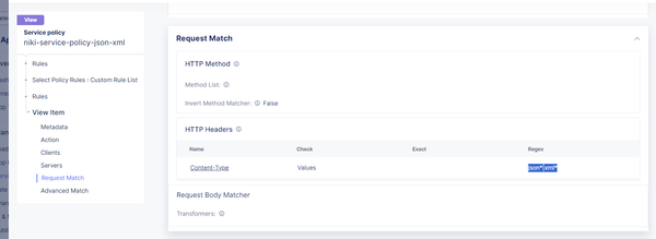

Keep in mind that in some cases in the XC Regex for example (1\.1\.1\.1) should be written without () as 1\.1\.1\.1 , so test it as this could be something new and I have seen it in service policy regex matches, when making a new custom signature that was not in WAAP WAF XC policy. I could make a seperate article for this 🙂

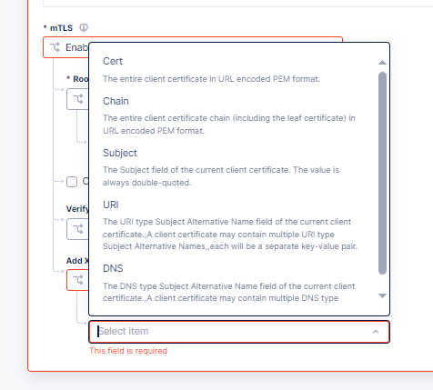

XC can even send the client certificate attributes to the backend server if Client Side mTLS is enabled but it is configured at the cert tab.
