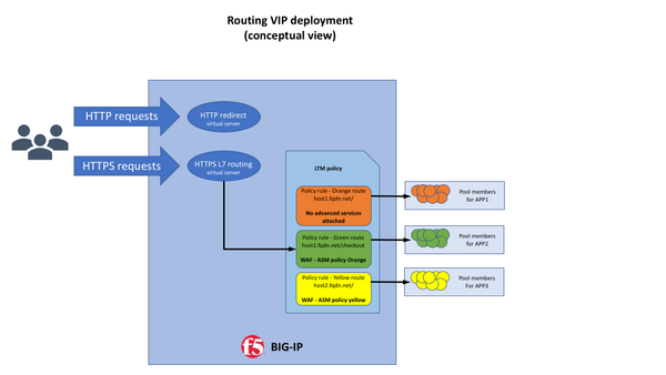

The goal of this project is to have a routing VIP handling L7 routes where each L7 route should be able to have its own independent advanced services configuration. This project demonstrates the extended flexibility of BIG-IP when regular mechanisms don't meet requirements.
How to use this snippet:
The picture below shows a typical scenario were we have a HTTP VIP that will redirect to an HTTPS VIP which will host the L7 routes implemented with LTM policies. This configuration is just an example and could be adapted to any other requirements.
The link below to the github site conatains further architecture information and the wiki contains the documentation.
