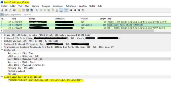

hi,
pls need your help, my VS is configured on ASM and it uses websocket technology, communication between client / server, I have a stake in the functioning of the application of this VS when we activated the ASM policy profile, we tested several suggested iRules by the community F5 but without result but when we disabled the ASM profile the application seems to work properly. the VS uses the code 101 during the response returned. also I see no blocked, tared logs on the ASM. I have attached the log captures without ASM and with ASM on the differential found. FYI, i use version 12.1.
thank you
