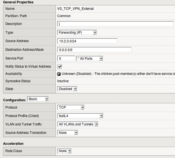

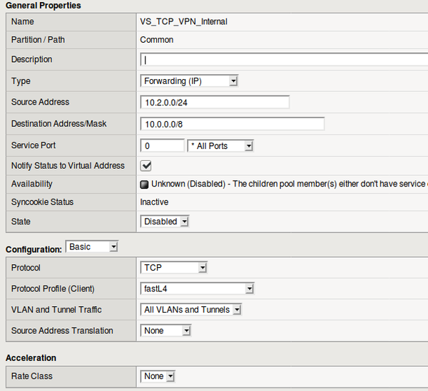

    Here are pictures of the forwarding VS I had configured and with which routing works. I had the same configured for UDP.
  • Hello TD!
    Your network diagram seems right, but I think you do NOT need any of those virtual servers to forward traffic. I recommend you remove (do not just disable, remove/delete) and test again and see if that works as you intend to.
    If it still don't work, I suggest you open a ticket with F5.
    Cheers! Rafael
  • TD's avatar
    TD
    That did the trick. :-D I deleted the VS and now it is working. I guess I had a routing issue in the beginning and accidentally solved this after I created the forwarding VS.
    But why didn't disable help?
    Thanks again for your help.
  • Disabling a VS still matches the traffic (which is a bummer, I know). You have to delete it to make sure!
    Cheers! Rafael
  • TD's avatar
    TD
    Ok, I get it. Thanks a lot for your help again.
  • No worries! Glad I could help. I'll post the comment to disable the VS as an answer and if you can mark it as correct. This could potentially help others in the future.
    Cheers! Rafael
