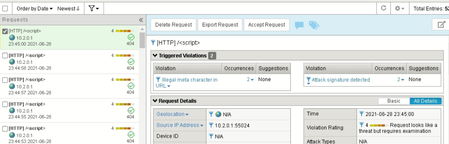

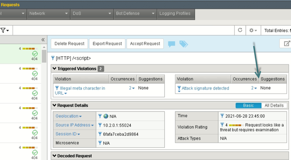

Violation not ASM learning suggestions
It should be accept suggestion to allow it. The AMS signatures have a Learn option under them but for violations is different.
https://support.f5.com/csp/article/K11533467
If you have issues learning signatures check if the automatic policy builder is enabled for the ASM policy and and check under signatures that the ""learn"" checkmark is enabled for the specific signature id:
- omar_padillaJun 29, 2021
Altocumulus
The question is why it does not appear to me as a suggestion option,
- Nikoolayy1Jun 29, 2021
MVP
If the policy builder is enabled then check for bugs:
https://support.f5.com/csp/bug-tracker
Maybe even a restart of the device may fix this. You may just restart the ASM process but better a full reboot as I had such issue before.
