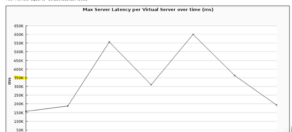

Hi
what is value on alaytic http ? is that mean 350.000 ms latency server
i feel confused what is exactly this value
1 Reply
  • Hi Anzine321​ ,
    I believe you might have the answer to your question. I’m adding a few comments based on the chat you’re presenting.
    A value of 350K ms on your chart means the server took up to 350,000 milliseconds — or 350 seconds — to respond during that time. That’s an unusually long delay and likely points to a serious issue with the backend server or network. It’s important to look into this to avoid performance problems.
