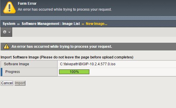

Dear amolari, I do like this guide. The first, i check md5 and match between BIGIP-10.2.4.577.0.iso and BIGIP-10.2.4.577.0.iso.md5 But, when i login Configuration utility and select System/Softwarre, I receiver error as blow:

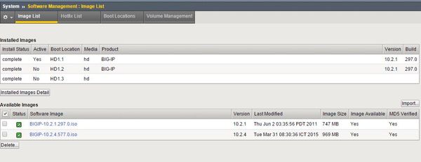

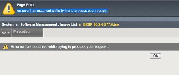

I copy successful by SCP via. as my picture. But, when i install, i receiver new meassage error.
