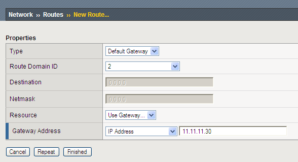

I have partition Common and I have created route domain %1 in that partition so I have route domain %0 (default) and %1. I would like to create default route for RD %1 but in software 11.4.1 I do not have "Route domaind ID" option field as is seen
which is soft ver 10.

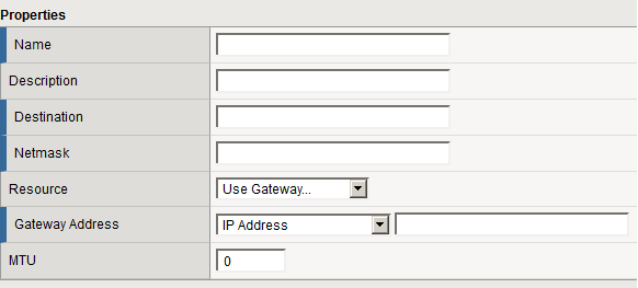

My 11.4.1 is like that:
Questions are: 1. Can I put 0.0.0.0%1 0.0.0.0%1 ip_add_def_gw%1 and it will only apply to RD %1? 2. Do I need to create another partition and make %1 as default for that partition? Or it is not needed and I can have %0 and %1 on the Common partition and %0 and %1 will not interfere with each other (strict isolation is configured)

    Questions are:
      -Yes, follow the %1 syntax for RD1 routes
      -You can have %0 and %1 in the common partition with strict isolation.
  • Thank you kunjan for your answer. I was asking this question because as you can see on soft ver 10 you can explicity choose to which route domain route belongs, on the other hand in soft ver 11.4.1 there is no such choise and I assume that BigIP will take route domain from the route 0.0.0.0%1 itself (as you said).
    Thanks!
