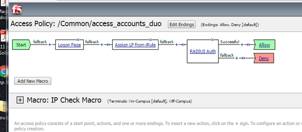

Here's the existing, and working, system: The user actually authenticates to another system (legacy stuff), then the F5 gets the username and password handed back via HTTP parameters. APM populates session.logon.last.username and .password from this info via iRule and APM Variable Assign. I show the user a blank login page, that has embedded JavaScript; that JS prompts the user to complete Duo's multi-factor auth process. Assuming this is done successfully, the session is established and the user can use our application.
(There's more to it, including iRules that completely disable all of the above for certain on-site IP addresses, but those are the important bits.)
Here's what that looks like in the APM:
(Ignore the "IP Check Macro" in the above; it's not used. The IP checks are now done via iRule, checking an IP list datagroup.)

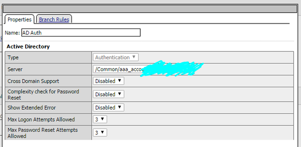

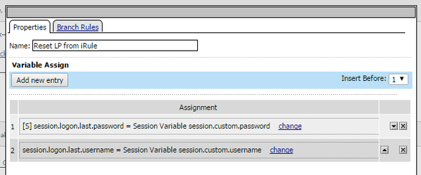

Could you send the screenshot of AD Auth and the code of "Rest LP from iRule" ?

In your VPE, the AD Auth does not have any logon page before to get username and password.

We have iRules that trigger on HTTP_REQUEST and HTTP_REQUEST_DATA, to collect the username and password from the HTTP payload, and store them in a table. Then, on ACCESS_SESSION_STARTED, I pull that data back out of the table and pop it into the session.custom.username and session.custom.password fields with the VPE action. (I don't remember if it was impossible to populate session.logon.last.x directly, or if it was just considered poor practice to do so.)
The AD auth is just a simple auth -- since the user has already been authenticated to our application, I don't need to do this. It's just simpler to do an auth, followed by a query, than to do a query with a service account.

I do not understand why you need to assign custom.username and password to logon.last.x parameters. They can be just used in AD auth as is. After hitting "Need Duo", What is the error on my.policy page? Could you share the screenshot?

The username and password are set by an iRule (before the user enters this access policy, the credentials are pulled from other HTTP POST headers). The credentials are provided before the start of the access policy, so I cannot set them directly in my iRule. I have to store them in custom session parameters, then use the first VPE action (a Variable Assign) to copy the custom parameters into the standard place.
