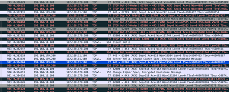

Hi,
I am in the process of setting up a transparent proxy with LTM, which will be load balancing browsing traffic two different internet connections.
There is a requirement that I direct traffic fo...

Apr 08, 2016Do you have SSL Forward Proxy license? It is not included in LTM license by default. What about URL filtering license? Try to remove iRules altogether and test to see if they are causing a problem?

Apr 08, 2016I do have the URL Filtering license... I did not know SSL Forward Proxy required additional license... Looking now it doesn't look like I have it.
I'm running this on a StrongBox at the moment (POC for client). I'll update my license and test again. Could you by chance provide the part number for the forward proxy license?
Thanks
EDIT: nvm found the part number F5-ADD-BIG-SSLFWD-VE
