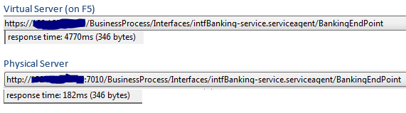

I'm Using F5 Standard VIP, protocol https configured ass SSL offload (Termination) which means that I'm decrypting SSL packets on F5 Box & sending traffic to an http pool. Actually this configurations works fine, but We noticed that there's a speed issue. when trying to transfer files or download/upload directly using physical servers speed is ok. when using F5 LTM VIP, speed rate is very low (up to 50 x slower) Do you have any idea about how to diagnose that on F5 LTM, or if there's a parameter I can change on VIP configuration so that I can improve speed over VIP.
just to give you more informations: - I changed the LB method from Least connection (member) to Round robin - The application we're working on is a reverse proxy solution. - I tried these Protocol Profiles (client) : tcp-lan-optimized , tcp-wan-optimized. but I got the same result

I attach a capture showing difference between VS & physical Server
- Yazid_Abdesslam
I tried with pool using different tcp port 7010 so servers actually listens on port 7010. - In https, your browser try to check for revocation status of the server ssl certificate. Did you do your tests on a browser or through a command line like curl ?
- Yazid_Abdesslam
Yes, I tested in Firefox & Google Chrome Browsers. even Curl command shows the same latency. (about 4 to 5 seconds to display/download) but directly from server, that works fine (less than a seconde) regards, Yazid

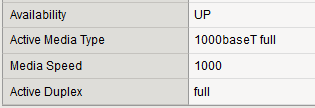

about interfaces : BigIP Side : Full Duplex 1000BaseT
Switch Core Side: Full Duplex Auto I just tried to force it to speed 1000 but same problem :( ..... you should also know that this Interface is used for other web applications, actual BigIP Throughput is 2Mbps (Limited at 6Gbps).
