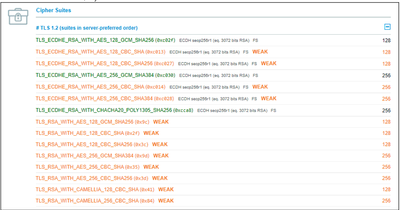

TLS weak Qualys report
Hi guys, Please help to identify the reason why Qualys scan gives this result about TLS protocol.
Is there anything to change on the SSL profiles ?
Thank you!!

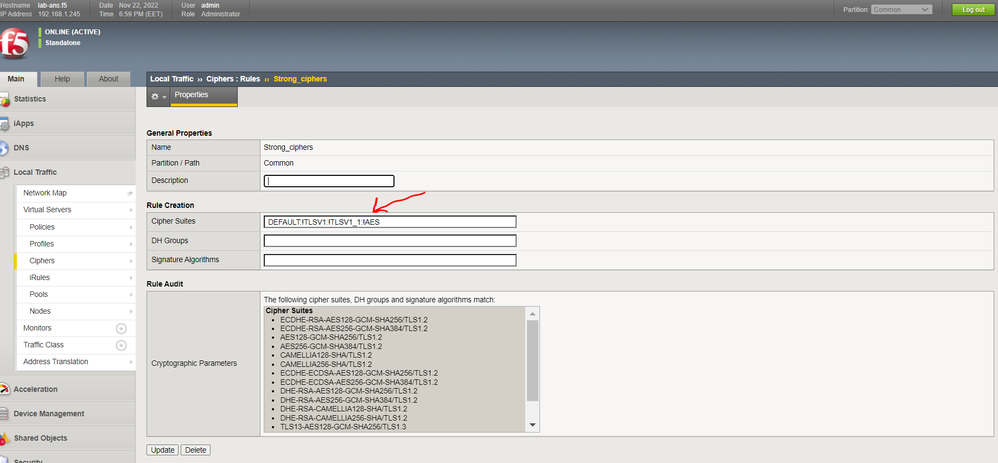

      First :
      > open (local traffic >ciphers and select Rules) ,
      and Create rule like this :

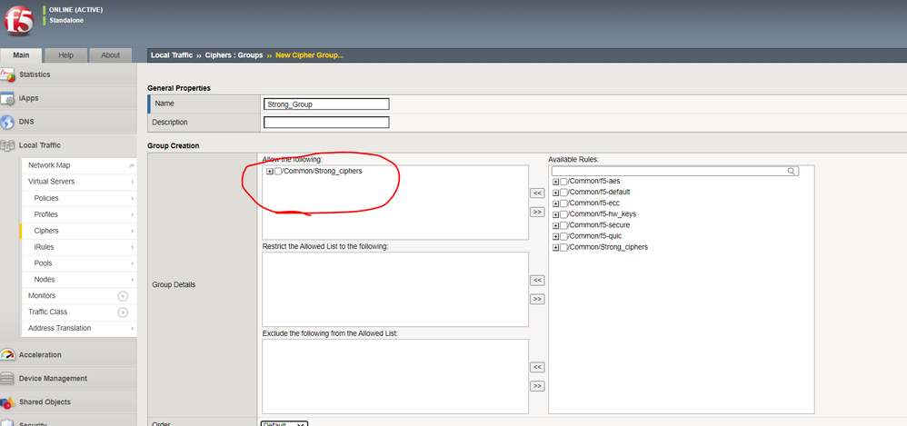

      > Then Create Cipher Group  :

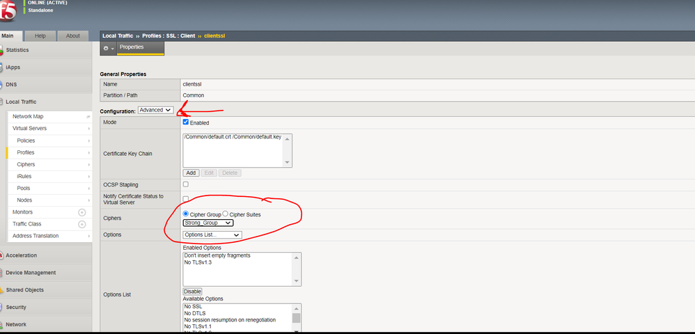

      > Then modify your Client ssl profile That attached on your virtual servers ( virtual server that you did the "Qualys " Test on , associate it with created cipher group.
      clarified here :

      > This is the used cipher in Rule :
      DEFAULT:!TLSV1:!TLSV1_1:!AES
      This Rule excludes TLSv1 , TLSV1.1, CBC
