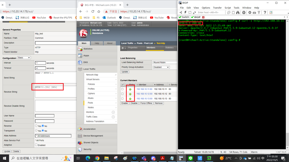

I am trying to create an http monitor
and Send String is
HEAD / HTTP/1.1
I want this string will accept HTTP status codes of 200 and 401. Any error codes (ie: 4xx and 5xx) will cause the receive string not to be matched and the check to fail.
So Receive String is
HTTP/1\.[01] [200][401]
But when I tried to do some experimenting I found it odd
EX.
I would like to ask why my curl web clearly shows 200 OK,
but my monitor does not work when I fill in 200, but it does when I fill in 401
Any help is appreciated.
use this linux bash to watch the pool member http response:
echo -e "HEAD / HTTP/1.1" | nc 192.168.10.11 80
and you Send String use HTTP/1.1, some web server maybe require you bring http Host Header,chang to this:
firstly use echo -e "HEAD / HTTP/1.0\r\nConnection: close\r\n\r\n" | nc 192.168.10.11 80
to watch the pool member response
Send String is HEAD / HTTP/1.0\r\nConnection: close\r\n\r\n
Receive String is HTTP/1\.(0|1) (200|401)

Why Send String is "HEAD / HTTP/1.0\r\nConnection: close\r\n\r\n"
not "HEAD / HTTP/1.1\r\nConnection: close\r\n\r\n"- xuwen
Cumulonimbus
According to the protocol, HTTP/1.1 requires that the request header should bring a Host Header(some web servers can be compatible with HTTP/1.1 requests without a Host, and some will return a 40X status code), while HTTP/1.0 does not require mandatory carrying of a Host. The web server code should be compatible with HTTP/1.0 requests. The Send String in the built-in http monitor cannot carry a $1 variable instead of node ip when your pool have more than two pool members, You can also use external monitor and curl in the Linux shell to detect
Bigip has a Linux shell template located in System ›› File Management: External Monitor Program File List ›› sample_ Monitor, you can use it after a little modification
