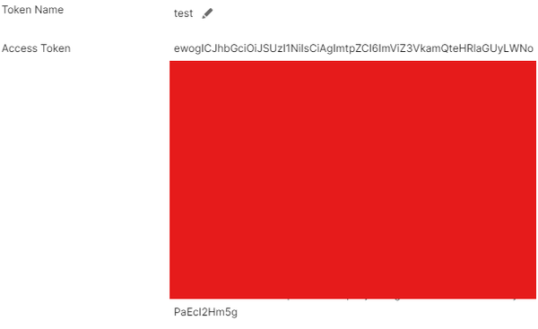

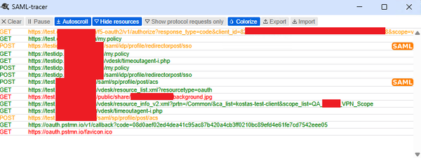

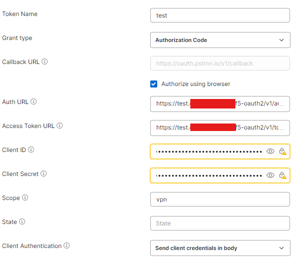

I believe that something is wrong with your config
In fact I just created a lab with this exact config and works as should
this my postman used as oauth clientas you see i use "test.xxxx.xx" fqdn for my oauth policy
now my browser redirects my to testidp.xxxxxx.xx with SAML
after successfull authentication in SAML IDP policy, i get the access token to postman from OAuth policy
if you share your config i might be able to help more.

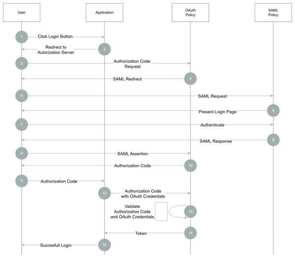

Just to be more clear below you can find the full authentication flow
As you can understand, if you have an active session in SAML Policy you will actually have Seamless SSO - BGill__CISSP__COct 24, 2025

Ok I see the issue now too.
Your federation is wrong.
You don't have to involve you saml idp policy in this federation at all. Your browser must return saml response to your oauth policy.
I thought this was clear before on my glow diagram
- BGill__CISSP__COct 28, 2025
Cirrus
Yeah.. I see what you are saying.. Step 9 is the assertion going back to the oauth policy.. I just had it cross wired in my head ;-)
