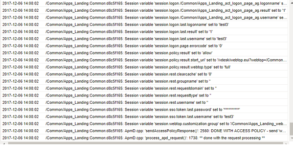

Hello All,
Requirement: End Customer should get selected weblinks as per user credentials provided.
Setup: Weblinks are on one VIP on same f5 but different URI EG: https://xyx.com/ab1 https://xyx.com/ab2
On a f5 APM landing page, I am trying to configure form based SSO to avoid dual authentication. but for some reasons its promptiming for authentication. Please Note: We have created same username & password on AD & backend SQL DB as well.
Please help to fix this issue.

  • Hello Boneyard,
    I spoke with the application team & they confirmed that its form based authentication which is needed. I configured the SSO profile @ Access ›› Single Sign-On ›› Apps_Landing_sso And mapped the same @ Access ›› Profiles / Policies : Access Profiles (Per-Session Policies) ›› Apps_Landing
    Please see the logs below:
  • with a debug log profile you might actually see a little more SSO related. if you use client initiated forms SSO then the debugging turns up in the /var/log/apm log.
    i also don't quite understand why you do per request processing, just on first should be enough.
