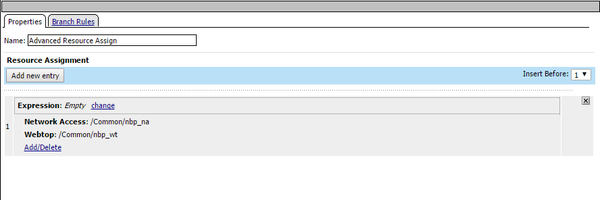

Hi,
Could you post the VPE in order to see your assignment configuration? Could you enable APM Debug log and then check and post the session variables?
Regards!

So you used the troubleshooting tool to remove all the F5 components and the try again to install the last version of Edge client from your BIG-IP right?
The next move is create a new VPN Network Access for testing. Go to the wizard and put just the essential objects in order to authenticate yourself and then hit the resource assignment.
- Songseajoon_222
I tried it but it did not work out.
