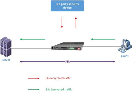

SSL Proxy with sending data to 3rd party security device for inspection
Yes...but...it's not the easiest thing in the world to do. The primary issues here are that:
ProxySSL only works within the confines of a single VIP and its corresponding client and server SSL profiles, so there's a very small layer 7 window where data is in the clear text, and that is only in memory.
There are no iRule events (other than layer 4 TCP) that get triggered below layer 7 when using proxySSL, so to use an iRule you're going to be limited to the set of available layer 7 events. In most cases you're going to be passing HTTP data, so all is not lost.
A clone pool won't work here either because it simply mirrors the whole port, which is encrypted below layer 7.
So, frightfully, you're left with an iRule that grabs HTTP data (request and response headers and payload) and sprays that to an external source via sideband call. And by virtue of the need to get a response, that remote source should be another VIP that "reflects" some data back to its source. Here's what the "intercept" iRule might look like:

And the VIP that it points to, the "reflector" VIP:
when CLIENT_ACCEPTED {
TCP::respond "HTTP/1.0 204 OK\r\n\r\n"
Because you're basically scraping HTTP data and sidebanding it, you also lose the source and destination addresses. I take the liberty here to add them as custom headers in the data sent to the reflector VIP. I should stop at this point and caveat all of this by saying that I built this a few months ago, and well, it worked then, so...
The reflector iRule will simply return with a 204 response. If you've set this up in "IPS" mode, the intercept iRule will block the traffic and send an error HTML page. If in "IDS" mode, it'll simply ignore the response. Whatever device you put between the intercept and reflector VIPs can simply block any bad data from getting back to the intercept VIP.

Yes, I know it's ugly and complicated, but ProxySSL imposes some unforgivable limitations here. And this is just one solution that I've been able to make work. Your mileage may vary.
