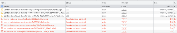

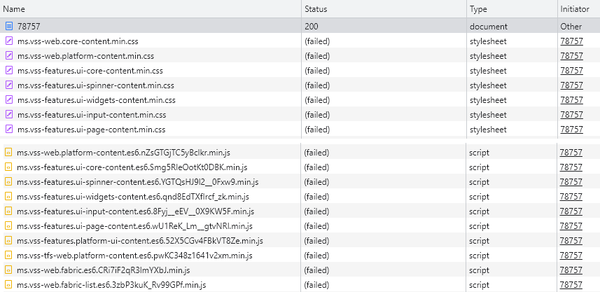

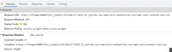

I found that first four requests are sent by google chrome over https:8080 but the rest of requests around 70 requests (js & css) is over http:8080!, i used the dev tool to check the issue it was blocked by chrome because mixed contents is blocked by default, i allowed it but still not working because F5 is expecting ssl traffic not clear text, to overcome this issue i configured new http VS with redirect irule (http to https), but i got another error which is "too many redirects".
how to solve this issue & why google chrome is behaving like that, sending clear text request after the first request, maybe the server is send instructions to the client to use http?
irule workaround (too many redirects)

Next requests: (clear http)
Before allowing mixed content
After allowing mixed content

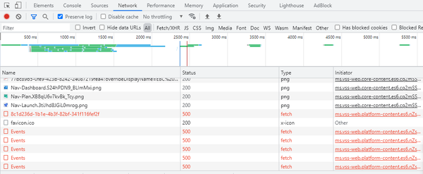

  • Thank you so much Enes, this i irule made the website loaded but still not fully functional, hereunder the devtool logs
    cannot fetch the events and status code is 500
  • i tried to access the same page without F5, status code is 204, and as per MDN wiki The HTTP 204 No Content success status response code indicates that a request has succeeded, but that the client doesn't need to navigate away from its current page. This might be used, for example, when implementing "save and continue editing" functionality for a wiki site.
    it's true because i want to edit a ticket, but the full content of the page is not displayed.
