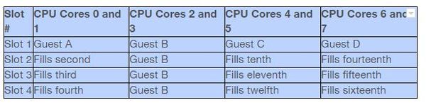

Hi there, I m trying to understand a concept about replacing a blade in slot 1 that has multiple single slot VCMP guests. Assuming I have this layout: where Guest A,C,D are single slot VCMP guests and Guest B is an all slot VCMP guest.
My first step would be to disable all the single slot guests in slot 1. Then I would have to create 13 temporary guests to work around slot 1? Then re-provision Guest A,C,D so they are allocated into the remaining unprovisioned slot/cpus before swapping blade out?
