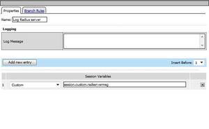

I'm using the APM v11.3 and I need to set an APM variable from an iRule which is bound to the radius VS (not the Access Policy VS). The goal is to log in the APM session, which Radius pool member ha...
