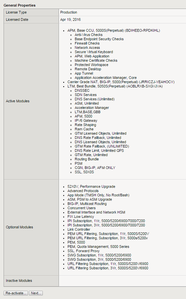

Hi all, so I'm missing the "Security" menu item on my F5 Big-IP running version 12.0.0 Build 0.0.606 Final. It is an option that's licensed, I will list my "Active" Modules or upload a screenshot here.
How do I get the Security configuration item to show?

  • Hi,
    the security menu is displayed when AFM, PFS or ASM are provisioned.
