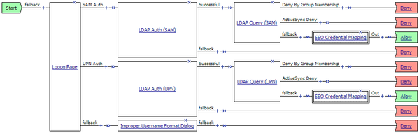

In our design, we're looking to process both SAM %DOMAIN%\%USERNAME% and UPN %USERNAME%@%DOMAIN% auth through LDAP Auths and Queries. To sum up our environment, we have multiple SAM NetBIOS domains, but each user account's UPN name resolves back to a single domain name. All domains exist within a single AD Forest.
I have constructed the following Access Policy which branches users based on the way they entered their account while adding some extra functionality you can note following the LDAP Query:
With the use of the Exchange iApp v1.3.0, the preferred logon type for the Outlook Web App is Forms. Using this type, we are able to auth users using UPN credentials without issue, but are being prompted with a secondary auth prompt from the internal server when using SAM credentials.
We opened a support case, and the workaround provided was to modify the %APP%_select_sso_irule2 to select NTLM auth instead of forms. This resulted in SAM auth working properly, but we later noticed that UPN auth is now prompting the user with a secondary prompt.
I believe the issue we're seeing can be corrected within the SSO Credential Mapping object, but I can't seem to figure out the logic to send the correct username to the internal server without getting inundated with "domain exists within the username" lines in the APM log.
Any ideas? Thanks!!

  • Cory, would it be easier to convert all user sessions to either UPN or SAM. You're already doing an AD query so you can override the session.logon.last.username with the UPN or SAM. It would simplify your VPE configuration and should resolve your double prompt issue.

    OK - After putting in some significant time, I've figured out how to solve this issue. We faced multiple symptoms that led to this particular problem, BUT I sincerely welcome the folks that write the Exchange iApp and associated documentation to provide feedback if I'm incorrect with my statements below.
    ISSUE 1
    Our Exchange CAS servers were configured to only accept Basic authentication in order to function properly with Forefront TMG. This has now been re-configured to utilize Forms-Based Auth as the Exchange iApp expects.
    ISSUE 2
    We have multiple internal domains within a single forest, so we cannot login with only a username. The username for OWA MUST be presented in a %DOMAIN%\%USERNAME% or %USERNAME%@%DOMAIN% format. Since the iApp has configured the Access Policy to Split Domain from Username, I reconfigured the Form Parameters field of the Forms-Client Initiated SSO Configuration to POST %{session.ldap.last.attr.userPrincipalName} instead of %{session.sso.token.last.username} for the username field. Obviously, you'll need to make sure you're running the prerequisite Query within the Access Policy to pull this variable so it can be leveraged.
