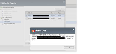

Rewrite Profile - 1 client URI maps to 2 server URIs
Hi, Paulius thank you for the information. This is a requested additional configuration by the end-user. Sadly, we're not given much details on why this must be resolved in the F5 side.
kristine_v I recommend going back to the end user and explaining why it shouldn't be done on the F5 and push them to make the adjustment on the server side. Just because something can be done on the F5 does not mean that it's the best approach, especially with this request. You might try the following iRule but I have never had to perform a modification to the HTTP header after the pool member has been selected. If you have more than 2 pool members then you would add in an "elseif" for each additional pool member. In the following you will replace x.x.x.x with the pool members IP for api22.
