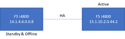

Original environment :
I upgraded one F5 to 15.1.10.2.0.44.2 and switched to Active.
The standby is constantly rerestarting tmm and the offline and standby states are constantly switching.
Tried two groups in the same state with the same results...
Has anyone encountered the same situation ?
(p.s. For some reason the customer is unable to upgrade the standby to 15.1.10.2.0.44.2...)
