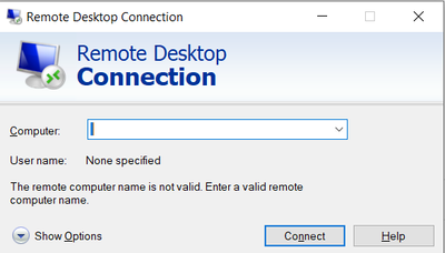

Hello,
When I use this KB https://support.f5.com/csp/article/K24493695, I have the following icon in webtop:
How can the RDP be published using the bellow RDP client in webtop itself.
Please advise.
Thanks !

  • So when you press that icon from the webtop it should download a rdp file.
    That file is only valid for about 5 mins and will load up your session via the f5.
    Just a note of warning, the SSO config needs a tweak so make sure its turned off in the first instance.
    The default domain parameter in the SSO config for RDP doesn't exist.

      Instead of download a RDP file, users need to load the RDP client to enter servername. Is it possible ?
      Thanks,
