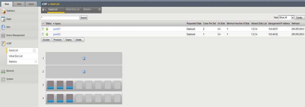

- On the Main tab, click vCMP > Guest List .
- View the graphic to determine the number of unused cores available on the slot.
This tells you how many cores are available to add to the guest.
- In the Name column, find the name of the guest that needs additional CPU cores and confirm that the Requested State is Deployed.

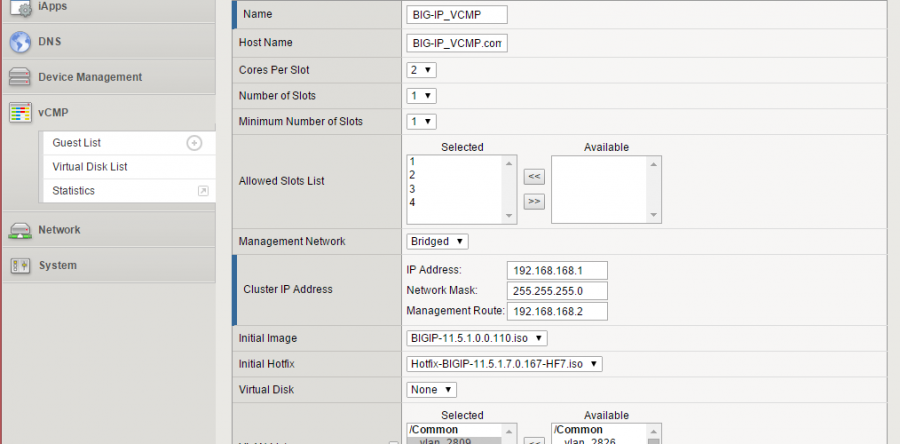

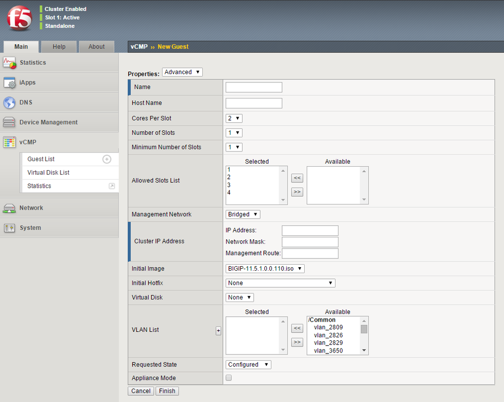

1. Connect to the BIG-IP Chassis (Host) and access with the appropriate user credentials and password;- On the main tab, click VCMP and Guest List, and then click Create.

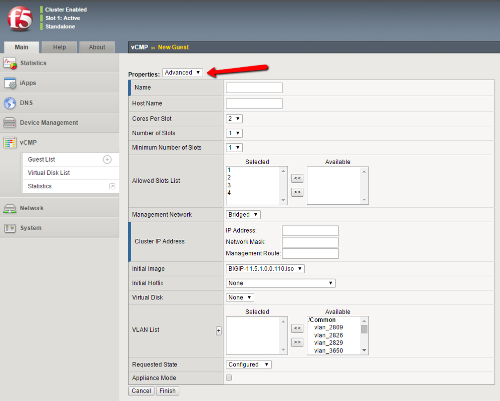

(Figure_01)- From the list of properties, select Advanced;

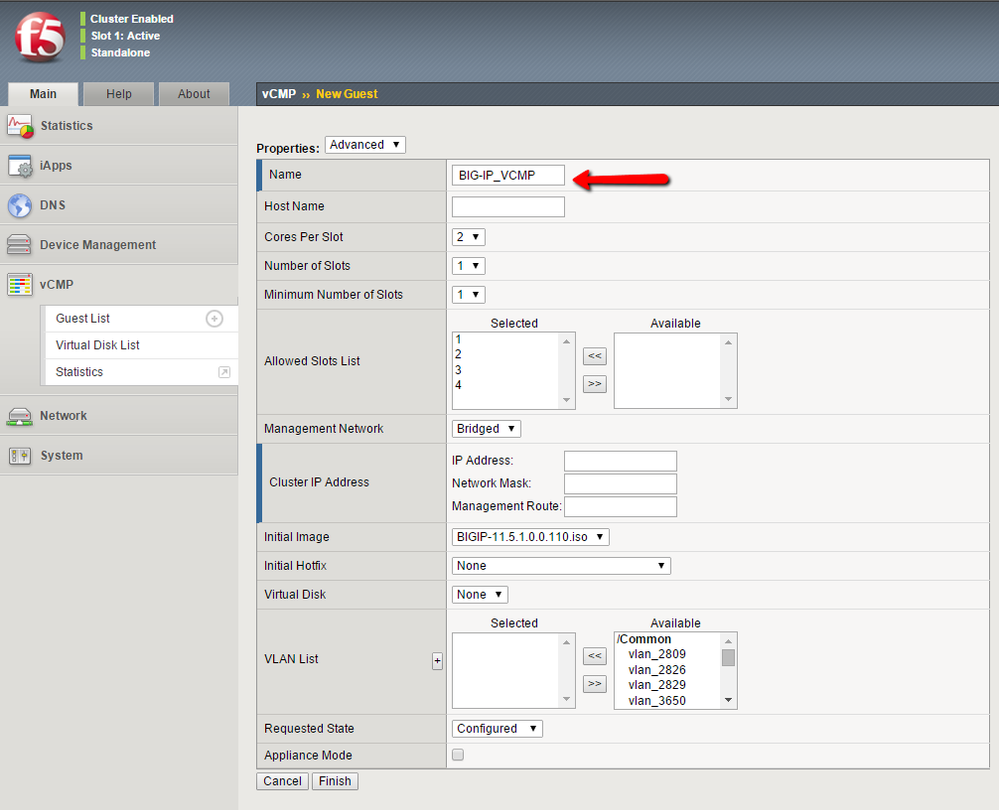

(Figure_02)- In the Name field, type a name for the Guest;

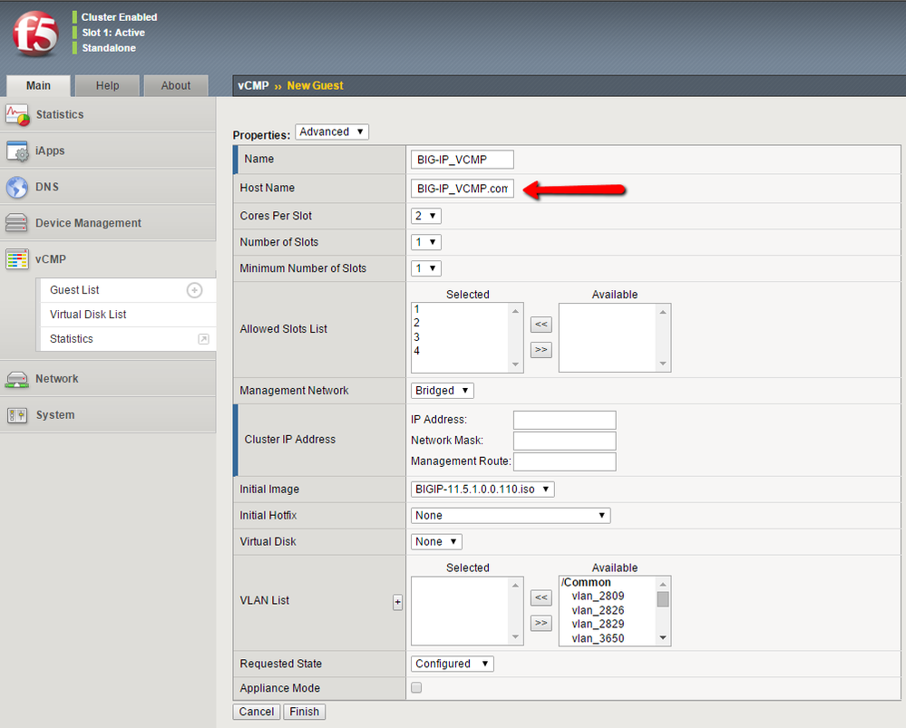

(Figure_03)- In the Host Name field, enter the host name of the BIG-IP system. Be sure to assign a fully qualified domain name (FQDN). If you assign a name that is not an FQDN, the system may display an error message. If you leave this field blank, the system assigns the name localhost.localdomain;
(Figure_04)- Choose the amount of Colors (Processors) that will be used by Slost;
(Figure_05)- Choose the number of Slots allocated in the equipment (in this case the equipment only has one blade);

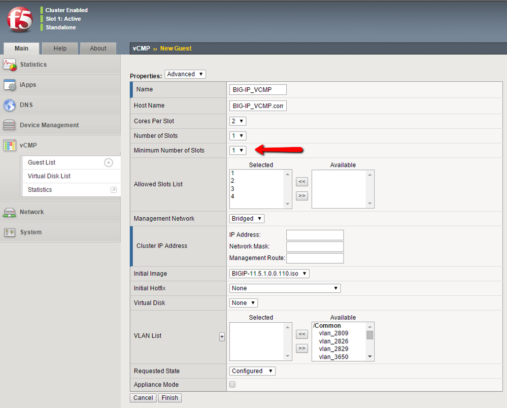

(Figure_06)- Choose the Minimum Slots Number. When choosing more than one slot, in case a slot fails, the VCMP will continue to function;

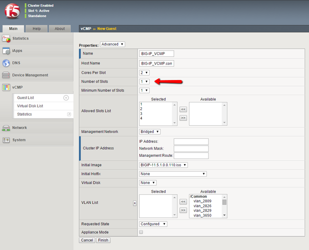

(Figure_07)- From the Number of slots list, select either single slot or all slots. This causes the Guest to reside in one slot or can span all slots. Note that once you set up a Guest to span all slots, you can not change this value later for a single slot unless you first change the Guest state to Configure.
(Figure_08)- In the IP Address field, enter a unique management IP address that you want to assign to the Guest. You will use this IP address to access the Guest when you want to manage a module running within the Guest;

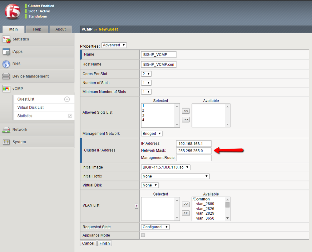

(Figure_09)- In the Network mask field, type the network mask for the IP address of the cluster.
(Figure_10)- In the Management Path field, type a gateway address for the IP address of the cluster.

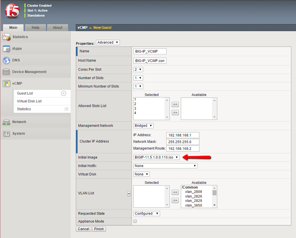

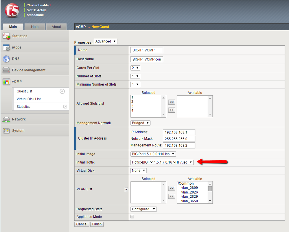

(Figure 11)- From the initial image list, select an ISO image file for the TMOS® installation and any licensed BIG-IP modules for the guest virtual disk (Guest). If necessary, choose HotFix for the System version.
(Figure_12)(Figure_13)

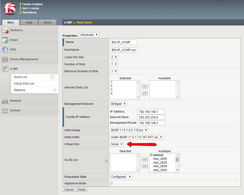

- From the virtual disk list, keep the default value of None. The BIG-IP system creates a virtual disk with a default name (the name of the Guest plus the .img string, such as guestA.img). Note that if a loose virtual disk file with this default name already exists, the system displays a message. You must manually attach the virtual disk. You can do this by using the tmsh command-line interface.

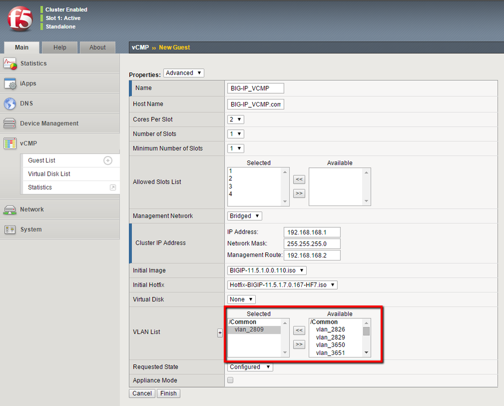

(Figure_14)- To configure the VLAN list, select an internal and external VLAN name from the available box, and using the Move button, move the VLAN names to the Selected box.
(Figure_15)

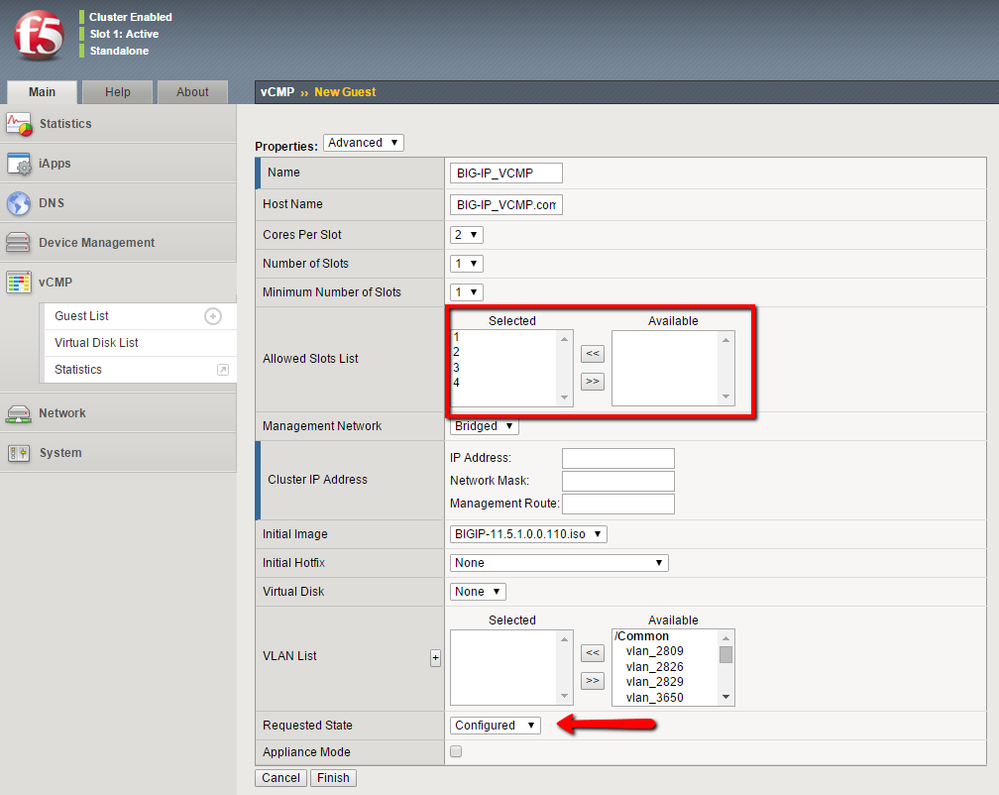

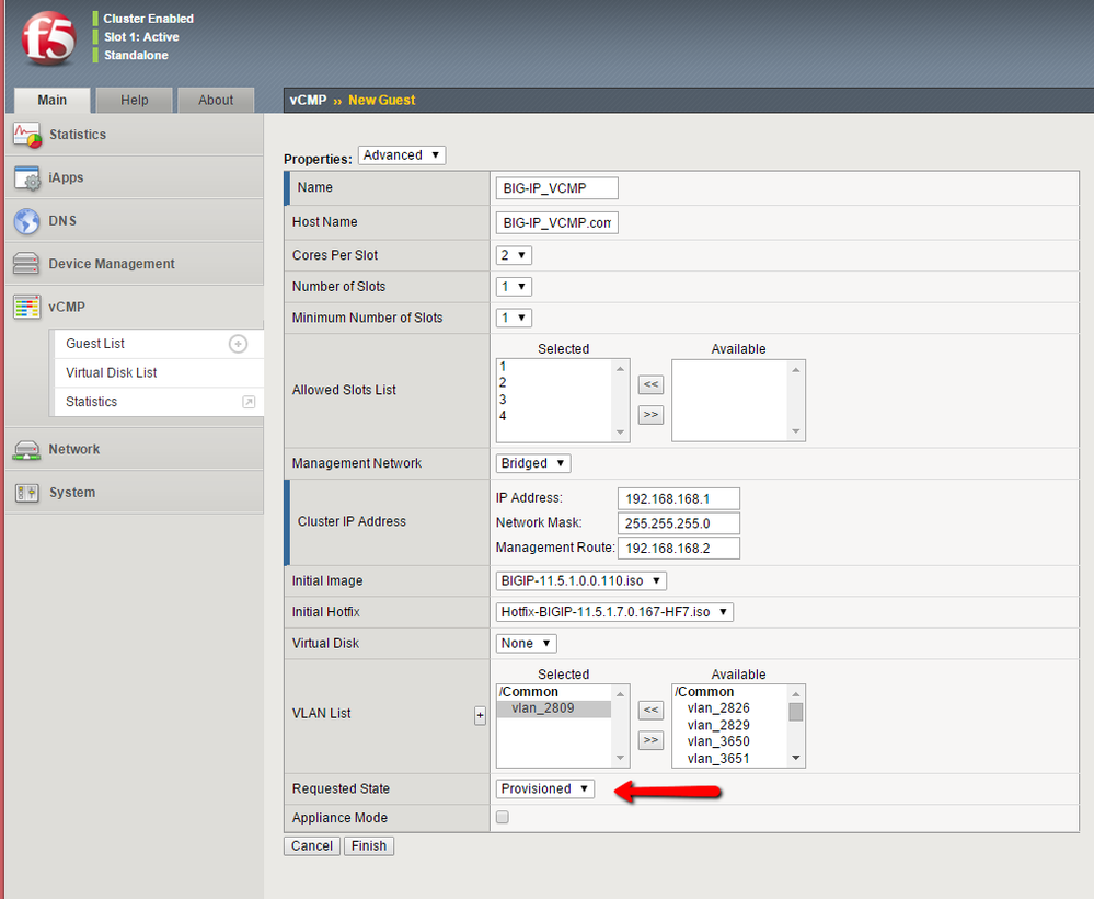

16. From the Required State list, select Provisioned. This allocates all the necessary resources for the Guest, such as CPU cores, virtual disk, and so on.
(Figure 16)- Click Finish.
