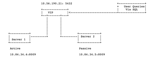

Redirect connection to a pool member based on http code
Hi, Our DB team has setup two POSTGRESQL servers and one is active and one is passive. They have come up with a request stating, is there anyway the LB can check HTTP error code, and if the error code returns 200 then the connection should go to that particular server.
I have seen here in DevCentral lot of posts about iRules checking for http codes. But i am a bit new and not sure about how can i achieve this.
So to summarize, the ask is.
if http error code is 200 in anyone of the server, then connect to that server.

      My setup is pretty basic :
      I think , i will go with your Plan.
      • However i need to know, do i need setup two health monitors..? 1) for postgresql and other for http code..? Not sure if there is a postgresql monitor available by default. Got to check.
      • Either one of the two server will be active per the DB team, so my assumption is the active one will always respond with http code 200. if it is yes, then the request will be forwarded to that server. And the other server will be down since it does not respond with http code 200, do you think this will work..?
    • krisdames_52343's avatar
      krisdames_52343
      You do not necessarily need to configure two health monitors. You need to determine what is the best indicator of availability for your environment. If an HTTP response code of 200 is the best indicator for you, then you only need the HTTP/HTTPS health monitor. In that case, you are correct in that the other server would be marked as unavailable by the BIG-IP because it does not respond with the 200 code.
