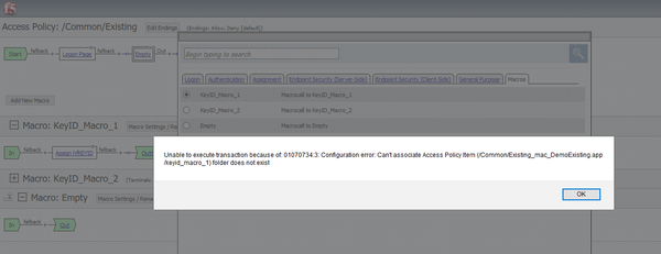

I am testing the iApp against version 13 of BIG-IP APM and I get the following error when trying to add the macro (which is created successfully) in an existing policy:
Unable to execute transaction because of: 01070734:3: Configuration error: Can't associate Access Policy Item (/Common/Existing_mac_DemoExisting.app/keyid_macro_1) folder does not exist
In this case I can't find any reference to
/Common/Existing_mac_DemoExisting.app/keyid_macro_1 in the bigip.conf configuration file, so I'm not sure how it is concocting that path. I don't have any other problems with my iApp in V13 so far - I'm pretty well versed with iApps / APM in general.

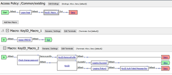

Screenshot from adding macro successfully in V11:
Screenshot from failing to add macro in V13:

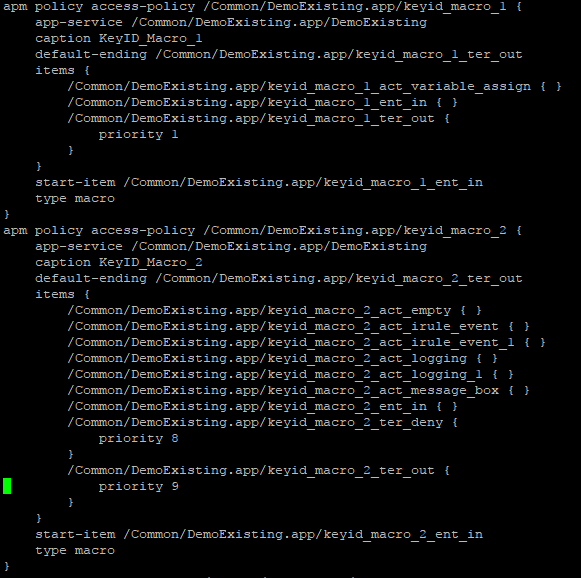

The macros are created by the iApp look like this in the bigip.conf file:
