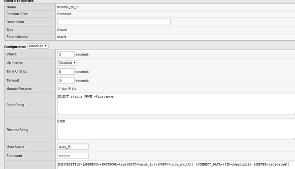

Hi, I'm having trouble setting up an oracle type monitor, I can't find a solution, we're doing a simple healt heck, the applied monitor is something like this:
tr7556@(F5-LTM-01)(cfg-sync In Sync)(Active)(/Common)(tmos)# list ltm monitor oracle monitor_db_1
ltm monitor oracle monitor_db_1 {
  count 1
  database "(DESCRIPTION=(ADDRESS=(PROTOCOL=tcp)(HOST=%node_ip%)(PORT=%node_port%)) (CONNECT_DATA=(SID=swproddb)) (SERVER=dedicated))"
  debug yes
  defaults-from oracle
  destination *:*
  interval 2
  password $M$JN$xrQa75yEutCc5w5cpQjV0w==
  recv OPEN
  recv-column 1
  recv-row 1
  send "SELECT status FROM v$instance;"
  time-until-up 0
  timeout 21
  username user_f5

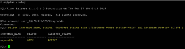

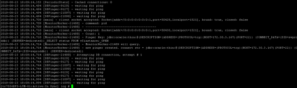

the query has already been thrown from a linux server and runs without problems, it is executed from a sqlplus and if it works, the credentials are fine and I am only consulting the state of the instance (see image), when reviewing the debug file I have something like this:
019-08-23 18:09:14,709 [main] - client socket accepted: Socket[addr=/0:0:0:0:0:0:0:1,port=50428,localport=1521], bound: true, closed: false
2019-08-23 18:09:14,709 [MonitorWorker-21488] - command: pid
2019-08-23 18:09:14,709 [MonitorWorker-21488] - ----------------------------------------
2019-08-23 18:09:14,710 [main] - client socket accepted: Socket[addr=/0:0:0:0:0:0:0:1,port=50430,localport=1521], bound: true, closed: false
2019-08-23 18:09:14,710 [MonitorWorker-21489] - Count: 1
2019-08-23 18:09:14,710 [MonitorWorker-21489] - Pinger Key: jdbc:oracle:thin:@(DESCRIPTION=(ADDRESS=(PROTOCOL=tcp)(HOST=172.30.3.167)(PORT=22)) (CONNECT_DATA=(SID=swproddb)) (SERVER=dedicated))_SELECT status FROM v$instance;_OPEN
2019-08-23 18:09:14,714 [MonitorWorker-21489] - MonitorWorker-21489 will query.
2019-08-23 18:09:14,714 [MonitorWorker-21489] - new pinger created. connect str = jdbc:oracle:thin:@(DESCRIPTION=(ADDRESS=(PROTOCOL=tcp)(HOST=172.30.3.167)(PORT=22)) (CONNECT_DATA=(SID=swproddb)) (SERVER=dedicated))
2019-08-23 18:09:14,714 [DBPinger-21489] - Attempting DB connection, attempt # 1
2019-08-23 18:09:14,744 [DBPinger-9129] - waiting for ping
2019-08-23 18:09:14,744 [DBPinger-9127] - waiting for ping
2019-08-23 18:09:14,744 [DBPinger-21097] - waiting for ping
2019-08-23 18:09:14,744 [DBPinger-21099] - waiting for ping
2019-08-23 18:09:14,994 [DBPinger-9129] - waiting for ping
2019-08-23 18:09:14,994 [DBPinger-9127] - waiting for ping
2019-08-23 18:09:14,994 [DBPinger-21097] - waiting for ping
2019-08-23 18:09:14,994 [DBPinger-21099] - waiting for ping
can someone help me ?, I have already read some references but I can not make it work

      • The node port seems to 22. Can you change it?
        (DESCRIPTION=(ADDRESS=(PROTOCOL=tcp)(HOST=%node_ip%)(PORT=1521)) (CONNECT_DATA=(SID=swproddb)) (SERVER=dedicated))
