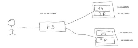

Hello,
I have this setup that i need some advise on.
I have 4 servers that will be connected behind 1 virtual server address. But there is a catch, the back-end servers form a sort of clust...

Jan 19, 2017Your solution with 2 pools looks good. As far as the question on using (1A + 1P) or (1A + 2A) for a single pool depends on your requirements. You can use a simple iRule to choose the 2nd pool based on availability.
